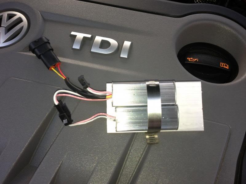

              HI Guys,
              I have received the LEDs from myliteco, They fit in the housing, They include a Resistor bank to cancel out the Can Bus Error so you need to find somewhere to mount them, I ran them for 5 minutes and there was considerable heat. I ended up mounting them on a piece of 10mm Aluminum Plate which also acts as a heat sink and secured them to the car using hose clamps. I did not want to drill any holes. The bracket for the horn is the best option I could find.
