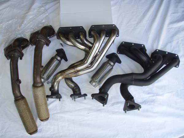

        These are the old R32 headers we used to build - you can see the stock manifold on the left & you can see the complexities involved in getting an equal tuned length in place (and unfortunately expensive to manufacture). The R36 is very similar in design.
        The problem with the original Milltek & Supersprint versions is they used a "rake" style, and the original Millteks lost power over stock.
        But as mentioned, you will spend a lot for not a lot of comparative gains (Comparative to a turbo car) - One great option is to trade it in on a B7 RS4 - that might be best use of your funds

          I can see why the headers shown would be expensive, thats some quite exotic pipe bending and welding going on there. What is meant by the "rake" style description? Also, you mention that one of the headers shown in the pictures actually "lost" power, wow, thats an expensive mistake, how/why would that be possible?

            Andrew, It's pretty easy to lose power, it comes down to design & testing, and some companies release products before they are fully tested.
            Exhausts especially, that header design wasn't our first - the first was a true 6 into 2 cross over design that made good power, but the car would go into limp after a couple of hours due to the sensors picking up incorrect pulses (firing order). Scratch 5k worth of design.
            the ones below look like a rake (picture for example only)
            If you look closely, you will be able to visually measure the difference from each exhaust valve to the centre of the collector (imagine the exhaust valve is equal distance from manifold port) and these are not equal - therefore no scavenging effect, and maybe no power increase & possible power loss.
            As mentioned, R36 engines are pretty much maxed out from factory, so changing something may give you the opposite effect.
