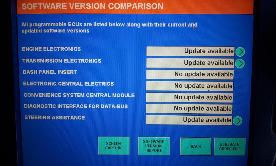

      The updates are for more electronic control units than just for the engine or the gearbox and some could take a long time to install and adapt.
      This is from 2009 Golf 2.0L TDI;

          Update ECU engine software finish...I left car around 8.00 am and everything was finish at 3.00 PM...
          Difference :
          Engine sound different...(yes, that surprised me)
          Acceleration is better,
          They did not update transs, but feel much better work..
          I was told that pd injectors need 200-300 km adopt to new settings...
          Will see

            Yes, that's what my customers report back as well, the improved turbo response (less turbo lag), better fuel economy and less smoke on the start up. I takes 1h20min with the Autologic unit. I recon I've done 8 engine ECU updates on TDIs this year alone.
