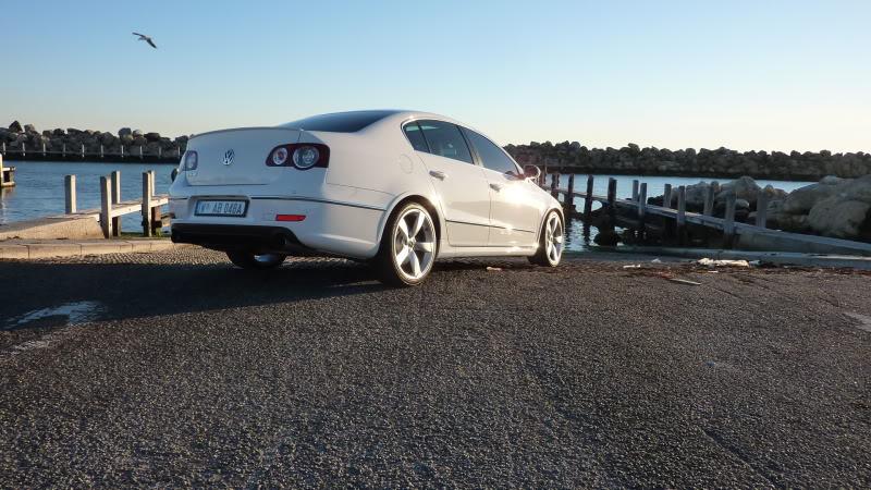

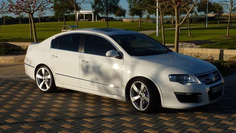

    I have the Hartmann 256-GS on my R36
    They are 19x8.5+38 (Have fitted MRR wheels 19x8.5+32 to my wifes Audi A4) so that should give you an idea of size and offsets

      hnaks man. That's very helpful.
      Has your car been lowered? If so, how much??
        Not lowered mate
        It's my daily and needs to be practical but IMHO the ride height is perfect ex factory
