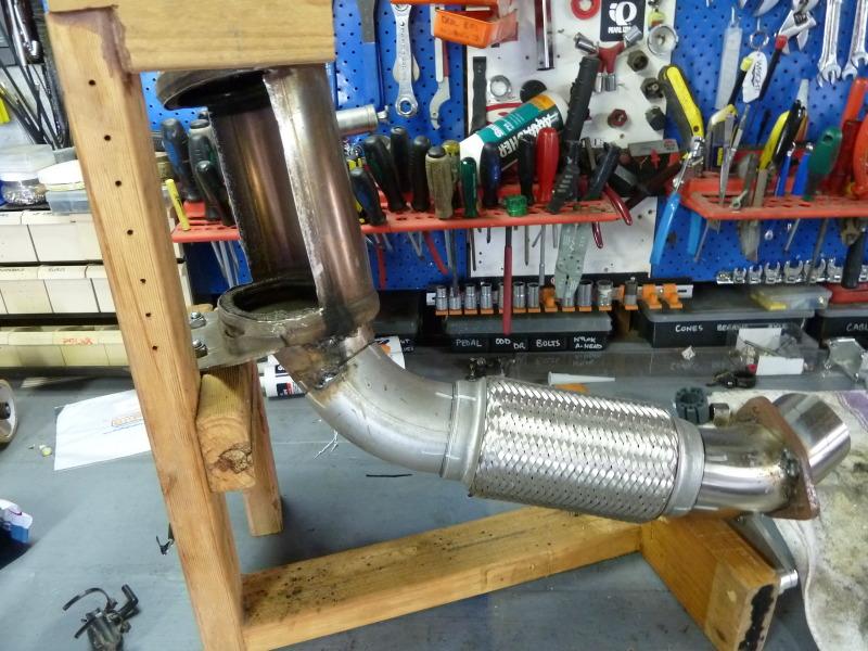

            I'm getting close to a solution, just at the stage of securing the right core - there is actually quite a range across companies - and test it on my TDI with a few tunes. The upside to all the delay is I have found what I believe to be the perfect core for the application, and the holdup is just trying to get samples out of Asia. Unless you want to order a container load these companies go quiet - may take a trip over there to be honest.
            Stuff you Gav , I want to solve my own DPF issue, this has been my longest build on a car EVER.....but it has been an eventful time. Certainly didn't start out with a car business in mind!!
