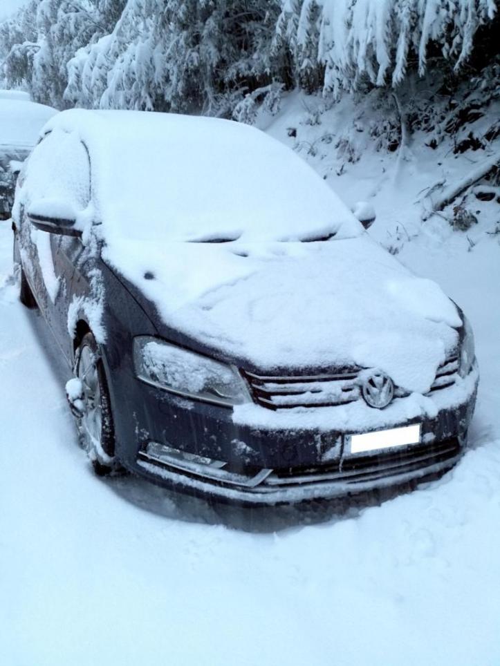

                Sure did.
                Here she is just 2 hours after I parked:
                BTW, the chains are still attached.
