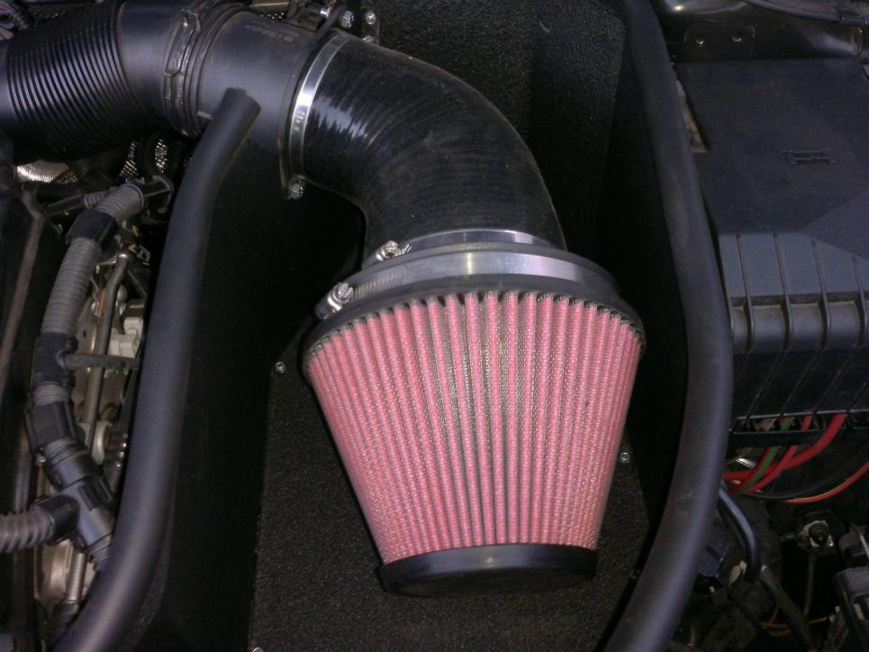

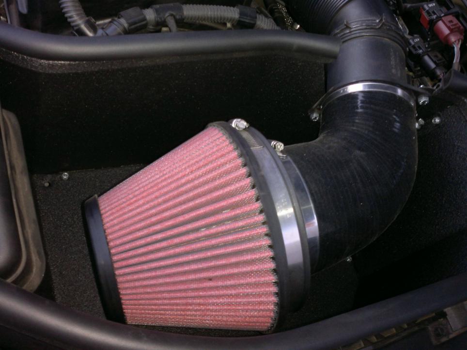

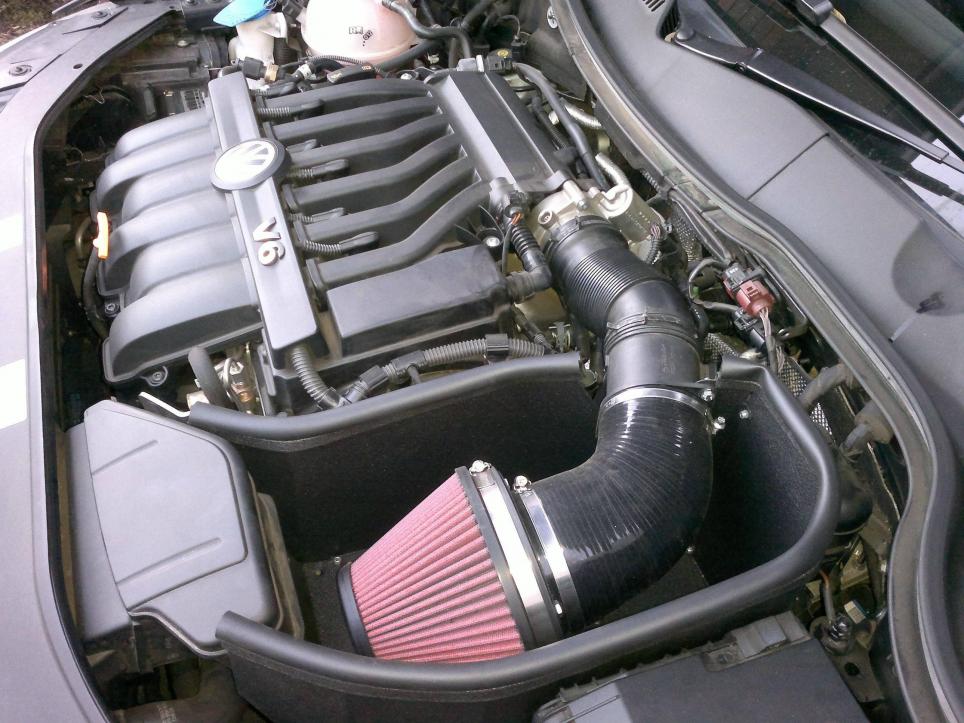

    finished install pics:
    the top of the airbox is "open" with a rubber seal, the idea is that the bonnet closes on top to complete the airbox and act as the "roof" of the airbox if you like.
    the standard ram-air feed fits into the box to feed it. it certainly provides good airflow as the box often appears dusty.

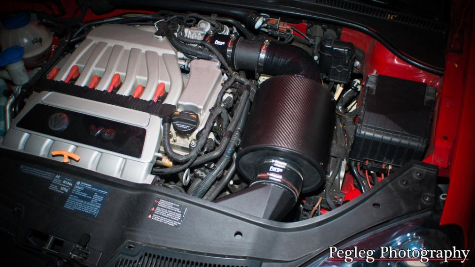

    I believe the carbon one you are referring to is the Gruppe M intake.
    These get quite a good rep however i am not sure of the legalities in some states where it requires the podfilter to be enclosed.
      Yeah that's the one the Gruppe M.
      Technically the bonnet closes to make an enclosed filter so it is fine. It would be easy to make a lid in fibreglass to go over the top if required
            Yes, it's the Gruppe M. I had one when i still have my R36. It does not have any problems with the police at all. I was pulled over one time for a random spot check by a highway patrol car. They looked at the gruppe M and it was fine.
            Besides making your engine bay look good, the induction sound it makes when you accelerate, is much better than the stock air box or pod filters.
            If anyone is interested, i have it for sale

                admittedly the Gruppe M is also very good looking and i would have that in a heartbeat but its too pricey.
                not a big fan of the look of the one above - looks like the "carbon wrap" you can buy sheets of on ebay
