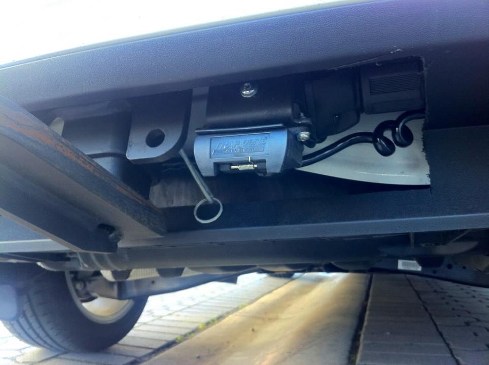

    Later in the week the car went to a local auto electrician to get a brake controller and anderson plug fitted. Upon collection the auto electrician apologised that they hadn't been able to ft the anderson plug to the right of the seven pin socket as we'd discussed and had instead had to fit it around several inches to the right.

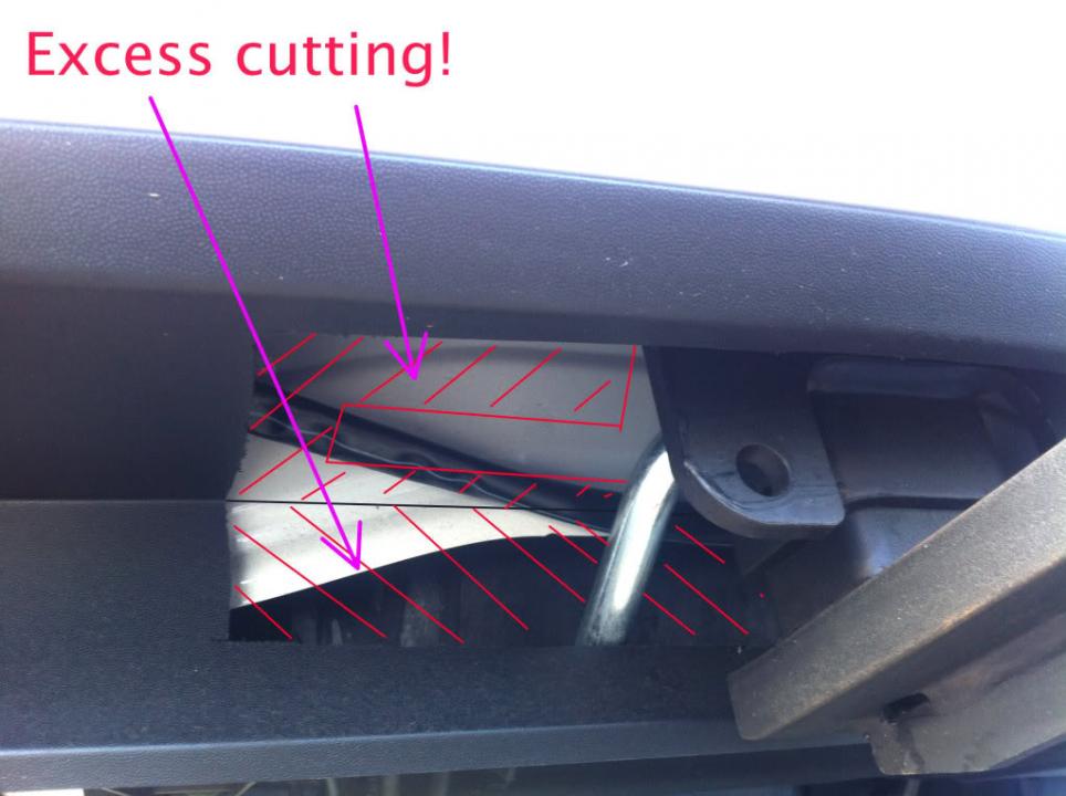

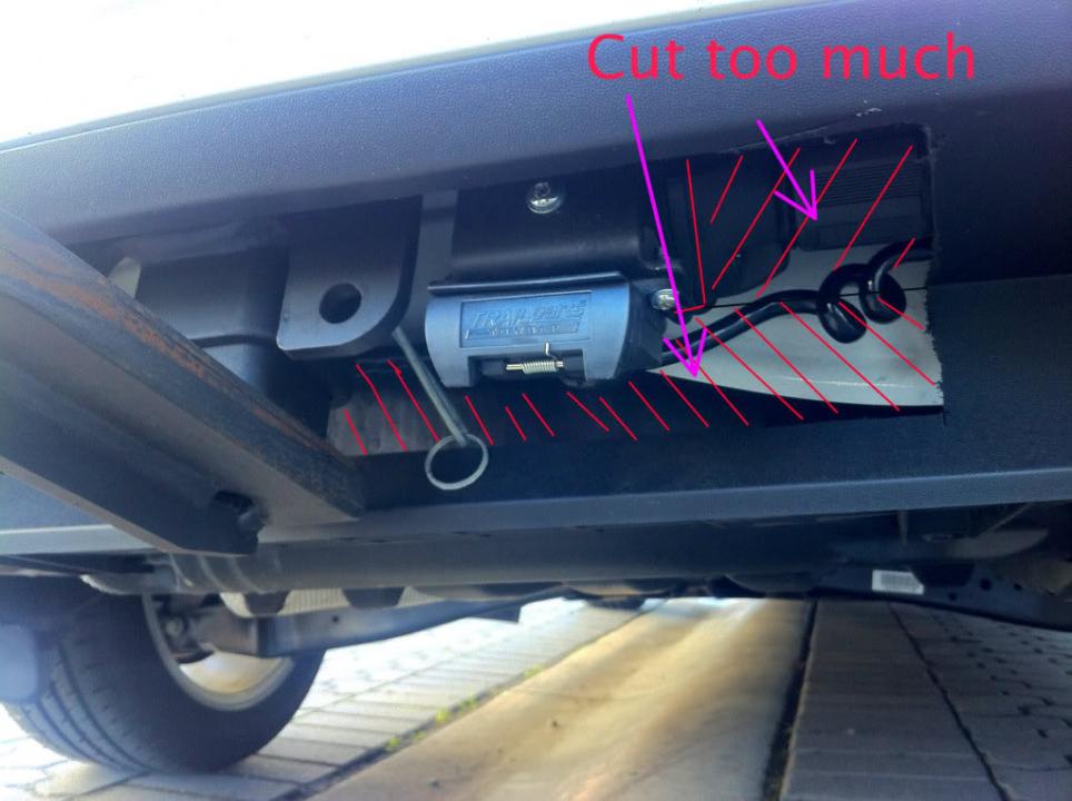

    The reason for the odd placement was due to an oversized hole cut by the VW dealer when fitting the tow bar. Rather than removing a section of the bumpers underside just sufficient for the tow bar to drop through, they'd cur a hole around 3 or 4 times that required. As such there was nowhere on the underside of the bumper to secure the new socket.

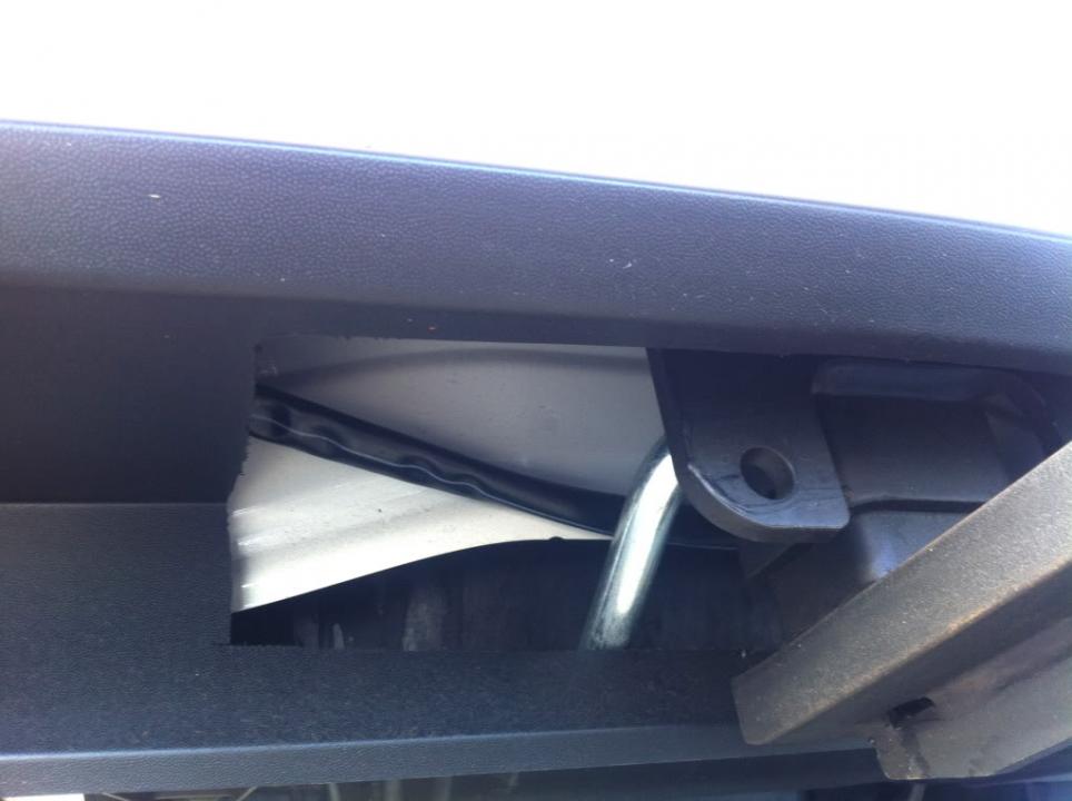

    Further to this.. the hole was very roughly cut (see pictures) and they'd carelessly gouged the rear section of the bumper during the process.

    That looks like some novice fitted it , .I'd be more than upset if that was my car.
      I would take it back to that dealer and demanded to fix it or replace the bumper bar.

        Agreed, that is a poor job. If any of the lads at the dealer that used to employ me presented that as their completed job, I would've complained on the customer's behalf. All cut-outs are ment to be neat, and filed smooth.
        Furthermore, why was the 13-pin -> 7-pin adaptor harness permanently fitted? Where is the bracket that is normally welded to left of the towbar tongue, that holds the 13-pin plug?

          Check once cut twice, that's my motto. 9 inch grinder not a dremel. Pretty gash job joking aside, get your angry head on.

                  The oversized cut out is however due to the position of the pin. It has to be as large as it is on the left so you can remove / replace the pin that hold the neck & towball.

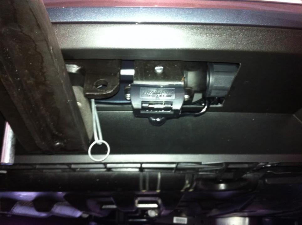

                    Having read this post, I was concerned about how my tow-bar install will go (have a new Passat wagon due to be delivered towards the end of June) - so went to the dealer to look into it further, and, guess what??, a Passat wagon with a towbar was sitting near the showroom. Stuck my head under the back end and saw this:
                    (view from left of tow bar)
                    (view from right of tow bar)
                    I was amazed at how much of the plastic they had cut! What gets me the most is why did they cut the vertical part of the plastic??? I think Russell (1st post), apart from the scratches, may have gotten away with a 'better' finish/smaller hole that this guy did!
                    Soon after seeing this (the car was just outside the showroom - waiting to get serviced I think), I spoke with the dealer rep handling my purchase and he has agreed (in writing) that their installer and I will speak about the tow-bar installation on my car BEFORE they cut any plastic. I had made it clear that if the bumper of my car is butchered this way, I will demand that the damaged part be replaced and a smaller hole cut before I would accept the car.

                      Yeah, that is pretty rough. No filed edges, over-cutting, scratching.
                      The front side of the valance doesn't need to be removed at all.

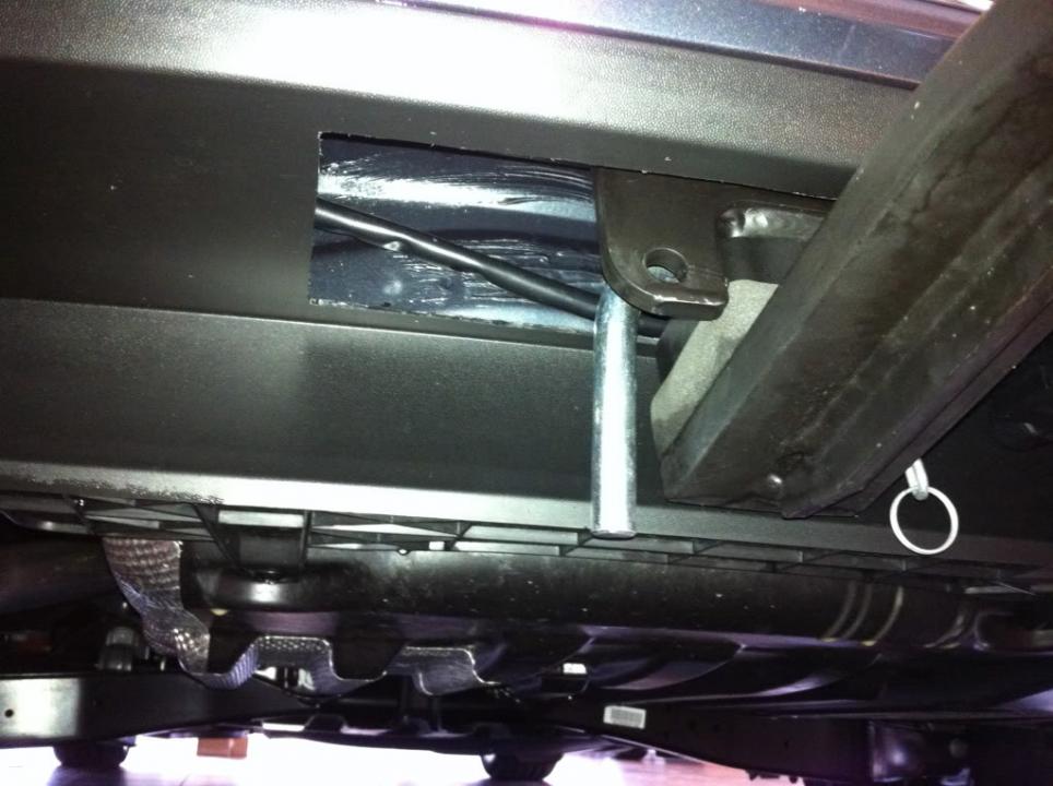

                              Update on tow-bar fitment . . . what I got on my car:
                              The Service Manager at the dealership I got the car from told me that the 'hack-jobs' seen around would not have been done by his people as all of them are factory VW trained and the strictly follow the factory guidelines . . .
                              While speaking with them, I also found out that if the car is a commercial delivery (i.e. company car, like mine) then the tow-bar (and other accessories?) is fitted by the service department of the dealership. On the other hand, if the car is a normal (consumer) purchase, the tow-bar is fitted by VW pre-delivery (i.e. before it gets to the dealership).
                              When I came in to speak with the Service Manager, his 2 guys doing the tow-bar install on my car had the rear bumper already off and the inside of the bumper very clearly showed the cut lines embossed on the plastic and they also had paper templates/drawings for the hole with VW logos on them.
                              I noticed that there were 2 cut lines marked/embossed on the inside of the bumper: (i) a smaller rounded/elongated oval one - I am assuming for when a tow-bar with no power connection is fitted and (ii) a larger rectangular one - for the tow-bar with power connection is fitted.
                              Having seen this and with a chance to speak with the guys doing the job to express my concerns about some of the tow-bars running around and how I wanted to have a neat finish with a minimal hole, I left them to it and when I picked up the car a few days later, this was what I got:
                              I admit that on the left hand side, the hole is (slightly) bigger than what I had hoped (would have liked) for it to be but apart from that it is neater than some of the examples floating about.
