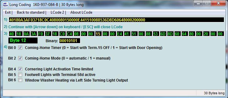

    Why do we have to continuously flash the high beam just to activate the coming home function. That is so stupid!!
    Anyone think the same??
    Anyway I found someone who coded the function so it works like it should.
    Anyone wanna try it and report back?
    Automatic Coming Home on Passat B7

                With my Golf I was able to change coming home so that it begins when I open the driver door for 30 seconds.
                Tick Bit 0
                Untick Bit 2 so you don't have to flick the high beams to turn it on.
