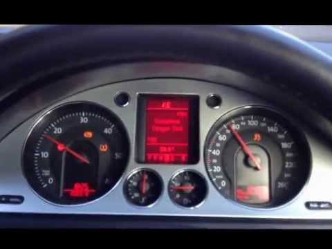

          Well bit of an update, I had the battery replaced a couple of weeks ago. It didn't fix my problem so I booked it in for a service and explained what was going on. In the end it had to be towed to the dealership (the tow truck driver and I are now on a first name basis) and they kept it for a week trying to find the problem. Decided it was the immobiliser so they recoded it and all the keys. Rang me today to say it was ready to pick up and that it was all fixed, but I got half way home and it started again!!! This time I took a video to show them when I take the car back in the morning...
          And it does that over and over again...
