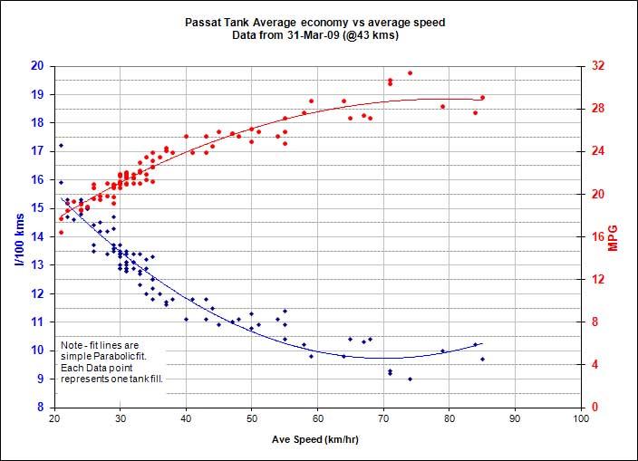

                            If you are concerned about consumption, you may want to consider the following:
                            (1) Record the kms (odometer) and litres added at each fill
                            (2) Concurrently record the ave speed and ave consumption (#2 averages on the display) when you fill
                            (3) Reset the averages
                            With this data you can:
                            (a) Correlate fuel consumption with average speed - over a number of tankfuls.
                            (b) Check the calibration of the in-dash display.
                            I do this and over 33000 kms on my R36 sedan I have:
                            - Overall Average economy from tank fills = 13.2 lit/100kms
                            - Overall Average economy from Trip Comp = 12.55 lit/100kms
                            - Average of average speeds = 38.86 km/hr
                            - Always fill with premium unleaded (9
                            Unless there is something wrong with your car, some influences would be:
                            * Driving Style
                            * Traffic conditions and average speed.
                            * Trip length
                            * Tyre pressure
                            FYI I live in North Fitzroy and commute to Port Melbourne every day. The engine temperature is up to normal within about 5 minutes, so a fair part of my driving is with the engine at operating temperature.
                            My correlation of economy vs speed looks like this....
                            Note my driving is generally 80% "sedate" and 20% "brisk"
