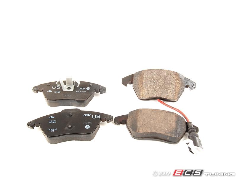

          definitely how else does the low brake pad warning come up on the dash. So can anyoen let me knwo how mnay km's they got before changing, I know Euro cars tend to have softer pads.
          ecs here
          Volkswagen Passat B6 FWD 2.0T > Braking > Pads
          pic
          B6 Passat Wagon No KESSY
            there's a dash warning for brake pads? cool
              Yep, that pic is of the later model Passat (C2, C5) pads, not B6, but the style of wear indicator is very similar, just the plug is a little different...
