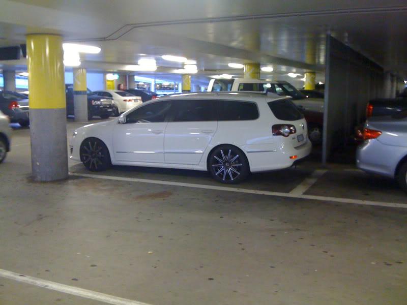

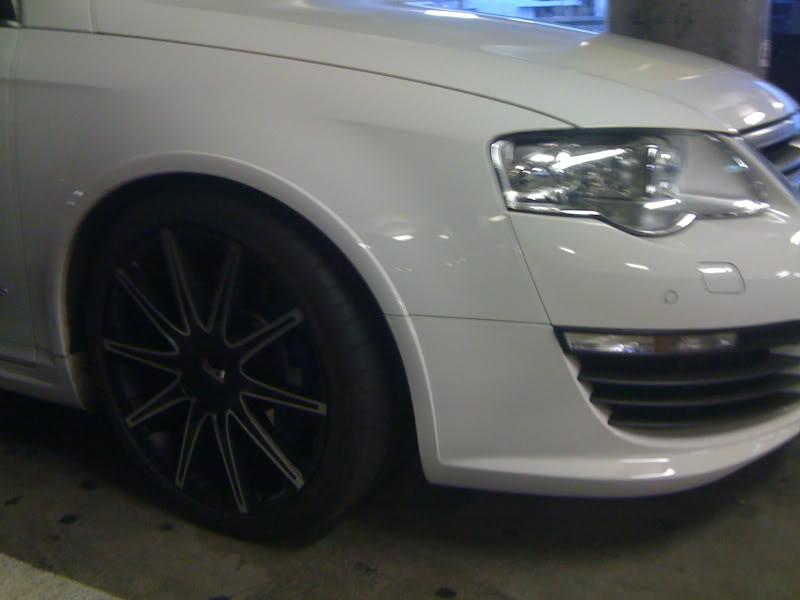

                spotted this CW wagon at the airport...very handsome 19's michelin 255/35/19 96y.....looked to be lowered as well....
                Is it anyone on here? It looked fantastic
                • #38
                  Image doesn't show up.
                  • #39
                    fixed
                    • #40
                      nice rims... what brand are they?
                      Gone...........R36 Icelandic Gray Wagon
                      Specialising in off-topic discussion
                      • #41
                        nice rims but they'd look better with a silver lip where rim meets rubber.
