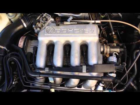

See video for what is happening. This is starting if cold, left over night and trying around lunch time. Car fires up, then begins to do this, coughing / surging with the idle. When it is warm it goes away and runs pretty nice, however the idle is too high ( not sure exactly as I don't have a bloody rpm guage, has a huge clock instead
Any help is much appreciated. Unplugging the coolant temp sensor when starting cold seems to have some effect, the car idles super low and nearly cuts out. Plugging it back in puts it back into doing this.
When warm, unplugging the DPR seems to lower the RPM a little... Cleaned all the grounds, thinking possibly the o2 sensor? TB and ISV cleaned out. No vac leaks...

Will chat to Dom. I just played around with the vacuum coming from the inlet manifold the one by the cold start valve. It connects to the oil breather hose and also attaches to the side of the air box. If I take this small hose off and cover it up with my thumb it brings the idle down. Can I install a catch can?? Block off the hole from the air box and vacuum into the catch can.
I would say don't do catch can, just fix what it should have. VW spend millions working all this kind of thing out and everyone is piggyback this and aftermarket that.
What are you calling the cold start valve. The 5th injector in the end of the manifold? Or the ISV idle stab valve?
This pipe here. It is so gunked up and destroyed, it had a tear in it on the bend from the crank case. I repaired a temp fix with silicon tape. The pipe on the right, that runs up to the cold start valve? Thats the pipe if I cover with my thumb it brings the idle down and seems to run a little nicer. The left pipe goes to the airbox.
