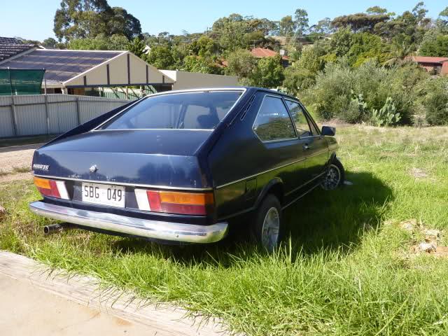

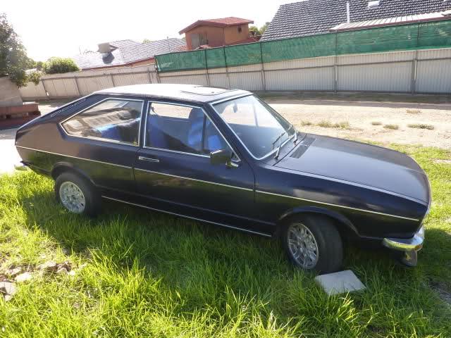

    Hey guys, bought another 1975 Passat TS. Was first notified of it on Wednesday when I saw the link on this forum. Called the guy 9.30 am in the morning, got at his place at 10am, made a done deal at 10.30am. Pretty darn happy with it.
    Rust is at a minimum, however the boot lid is rusted, but acquired a 98% rust free boot lid thanks to Nick_80. Little bit of rust under the rear quarter panel. Other than that the car is pretty darn straight rust free. Needs a definite respray as the paint on the roof has pretty much faded away and cracks in the paint are everywhere. And the dash is.....well......its a B1 passat dash doesnt require much imagination......cracked everywhere and the carpet on top of the dash has been glued down on by what looks to be industrial strength glue. The previous owner also put a type of anti cracking resin on it which I think over time gave it a "crocodile skin" like feeling on the dash which isn't pleasant.
    The mechanical side is another story, steering is like wrestling Arnold Schwarzenegger in his prime, The engine runs not too bad, changing gears is abit "sloppy", Brakes are rubbish, has a sports exhaust system which I'm going to weld in more mufflers since its way too loud for my liking and doesn't sound that great and brings too much attention.

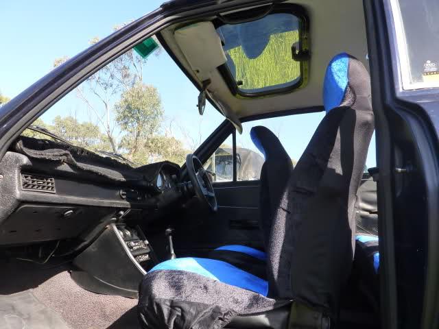

    The interior is pretty decent for now. Seats are in OK condition and quite comfy as the TS came out with Recaro style seats. The back seat is in good condition but got an even better one from my Passat LS which is the most comfortable Thing I have sat on.
    Driving down the highway I noticed that the speedo metre shows an additional 10-20 km/h on it, So while the speedo said 90 or 100 km/h I was actually doing only 80 km/h (which explains why sooo many people overtook me).
    Plan is to upgrade to Mk 3 golf brakes all round which will solve my brake issue, and basically do a full resto. This car is going to be used as my DD so I want to resolve all mechanical issues ASAP. I've got a donor car (my LS) which makes life so much easier in regard to the little things.
    Here are some pics

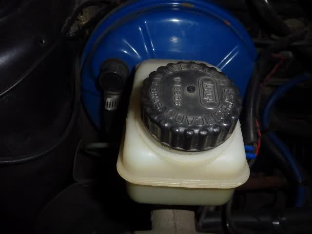

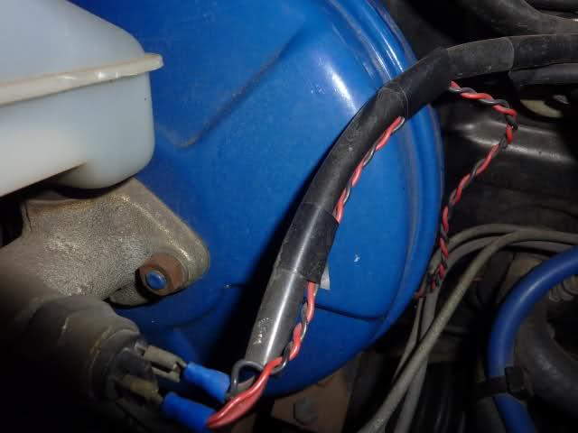

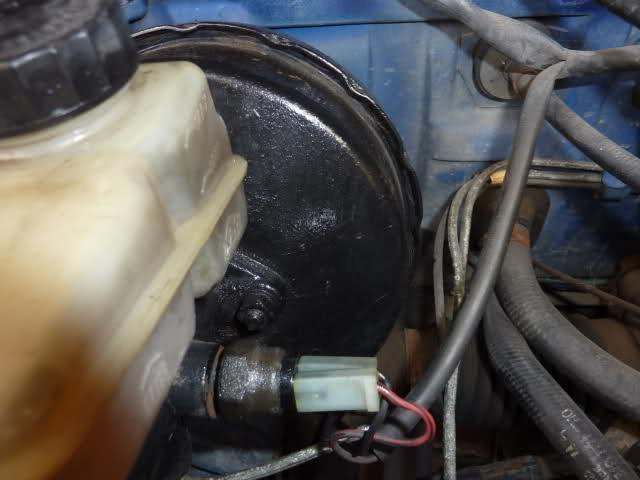

                However I got a problem now, I need/want to upgrade my Brake Booster and Master cylinder. But the set up is different to a Mk1, The original brake booster is sitting right next to the tower (Dont know specific name) the images below will show what I mean.
                The calipers I picked up.
                Original Brake Booster, See how its directly next to the tower. Not sure if a Brake Booster with a larger diameter will fit straight on as it might hit the tower.
                Now heres a couple of pics from the same model vehicle but with a bigger brake booster on it. I'm not sure how they accomplished it, maybe they relocated the brake pedal im not sure. If you know what car this booster came form or the model please tell, It looks to be different from a Mk2 and 3 because of the pattern it has on the front, aren't Mk2 and 3's usually smooth?

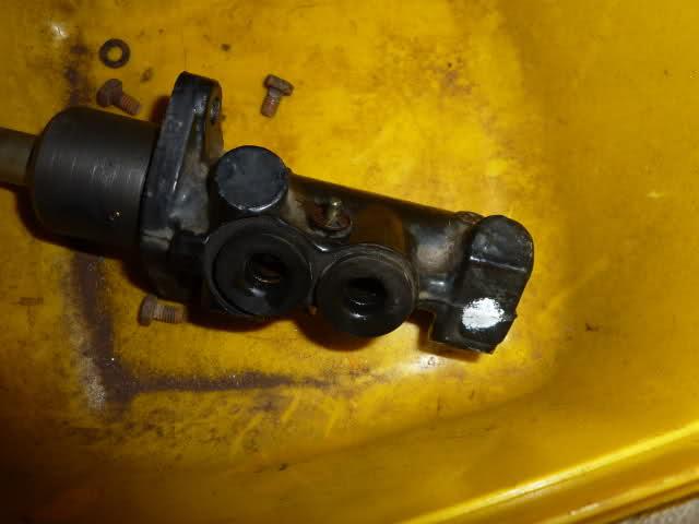

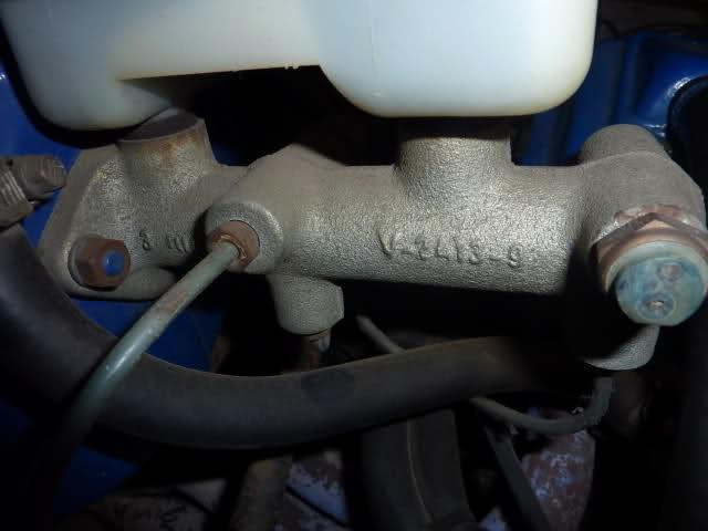

                Any Idea what type of master cylinder this is?? Looks original??
                If you have any idea's of how I should approach this please tell.
                -'75 Passat TS
                -'75 Passat TS (Project)
                No....its not a Piss-sat its a Pass-sat!!
                  audi 4000 booster, i'm pretty sure there bigger and fit the same holes, and you can get them fairly cheap off ebay!

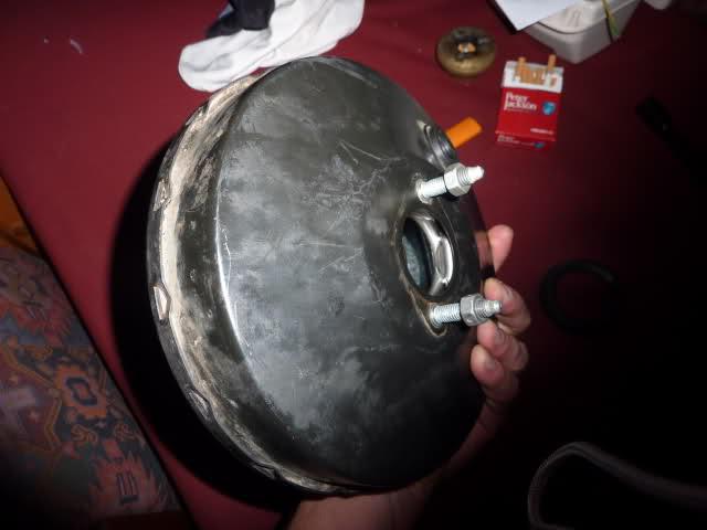

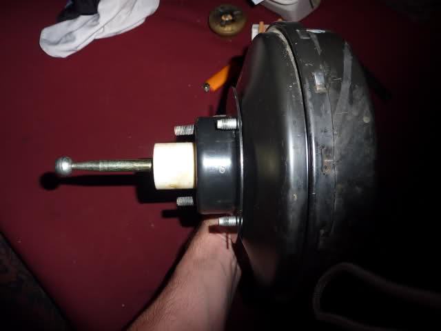

                      Got a Brake Booster from a Seat Ibiza today, luckily it fits, really tight though. Also got the Master cylinder from it. Im not sure if I should reuse my original Master cylinder or the one I picked up. Since my original also fits the brake booster and has got 5 holes for the 4 brake lines and the brake light. But the Seat MC only has 2 holes and I haven't got any T sections as well.
                      Would the performance suffer as a result of using my old MC??

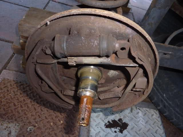

                        Got two sets of scirocco rear proportioning valves from the US thanks to the people on vwvortex, yes they are 3-15 and no they are not cheap. Ordered some front brake pads from the UK since they were closing down and selling at 10%RRP (15AUD shipped to me). Unfortunately rear drums just dont have the sex appeal rear disk brakes do. So now just gotta hunt down a rear brake setup from a mk3 golf.

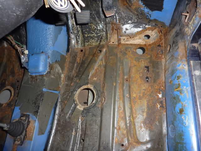

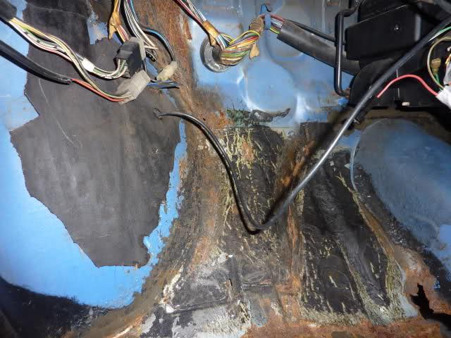

                        update on the rust, front section of my floor pan is not looking too good nothing major but needs some metal work done, Im not a welder so was planning on pop riveting sections of sheet metal from the bottom and top and going over with the 10 litre can of tar I found at home. Obviously treating the rust and primering it before tarring.
                        Hopefully get some pics tomorrow.

                            Heres a few pics of the extent of the floor pan damage.

                              Plumbed up the front section over the weekend since I was bored. Here's some pics of the pipes I made and the scirocco rear proportioning valves.
                              Heres the weld of the push rod for the brake booster.
