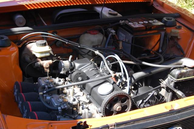

      loving your work dude! Looks great! Bet you'd never get sick of that induction noise either!
      • #18
        Never get tired of that induction noise. I think I have only turned on the radio once since I fitted them. And then it only lasted 5 min till I turned it off because I missed the noise of the webers haha.

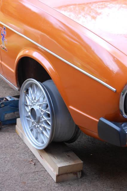

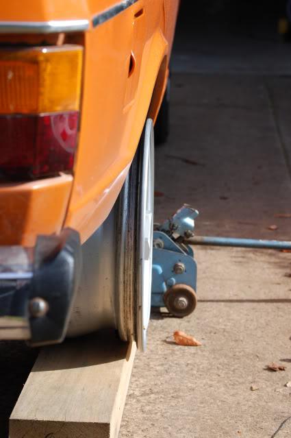

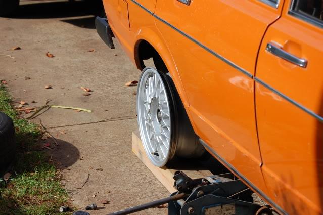

          Well things have been slowed down a little with the old girl. Did Get some nice BMW 14" BBS wheels from Intensem1 a little while back and couldnt be happier with them. I have been umming and arring about what type of wheels to get but these came up for sale and just had to have them. No tires yet though. Still deciding what size I want to go with...

          Engine bay still messy but its slowly on its way. Twin webers still burble and roar

              How do you go about getting stuff ot lower these things?
              • #22
                Man you got the exact same setup I want for my TS, BBS wheels, twin webers, clean engine bay set up, clean interior, good condition paint job, man just gotta love the old cars. Was wondering since you've had the twin webers on for a while now hows the performance? significantly more power than the old set up you had before? and hows the fuel consumption? You reckon you could take some more photo's
                From what I know GolfMan, You make a couple precise measurements, take a diamond tip saw, say a couple prayer's, then cut the springs.
                  Hahaha thats it. I have spend many many hours searching and have come to the same conclusion. Its the easy way out. Hard way (and has been done before with success) Is to actually cut a section of the strut and remove what ever desired length. Insert Golf MK1 strut inserts because their shorter. Buy Golf mk2 front lowered springs and top spring cap? Or coilover sleeves. Seems like a too much stuffing around. I am willing to try it one day though with a spare set of struts. Till then Ill stick with the diamond blade.
                  I was never gonna expect significant performance increase bolting twin carbs on a flogged out, bog standard FN 1.6 engine. But There is some slight performance increase, seems to have more poke through the mid rev range. It is a bit quicker but not quick enough. Sounds great though. Fuel consumption is a little higher but not so much that Im worried about it. Never been one to care about fuel consumption anywho. The way the carbs are set up I believe will work better for a 1.8L. Include a nice camshaft and I reckon it will be enough for these old passats. I could stuff around with the 1.6, bore, port & polish, cam, gears etc....But thats just wasted money when a mk3 1.8 will bolt in

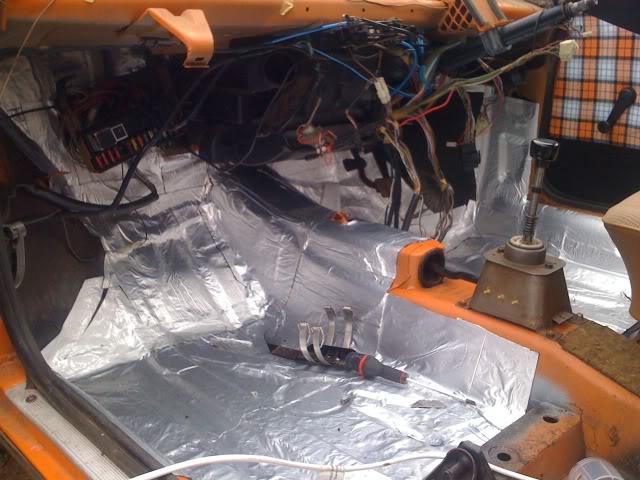

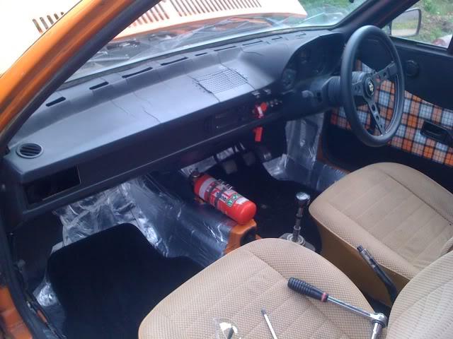

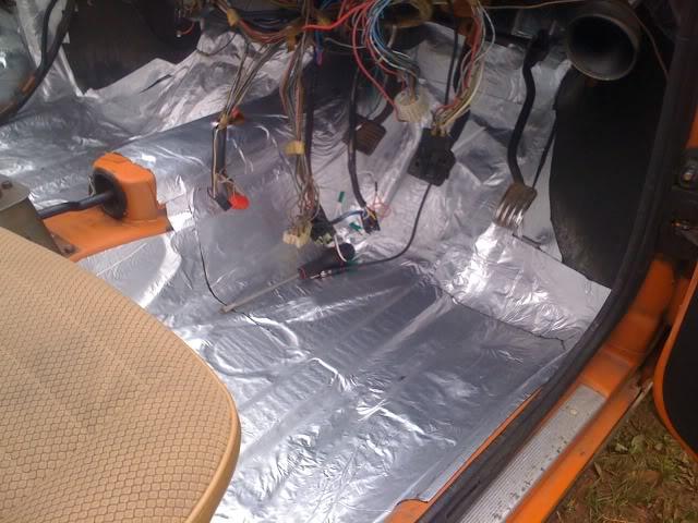

                      So, been working on the Passat a bit more of late. Spent the weekend treating the rust with POR 15 products and placed sound deadening (edead) on the firewall and front floor pans.
                      Replaced the huge standard Passat B1 steering wheel with a new MOMO Prototipo. Had my eye on this wheel for a wheel. It keeps with the 70's style of the car that I desire.
                      Next up will be some dense foam for the floor, then I need to find a decent carpet dye to redo the original carpets. Some new tyres for the BBS will be next as well as some Recaros. Reupholster the dash with black suede. Bit of a list at the moment but its getting there

                        Does the sound deadening work?

                          The sound deadening definitely makes a difference. I like your approach here.

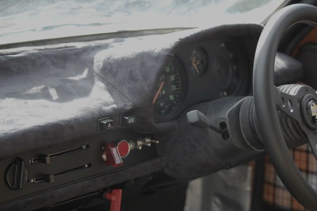

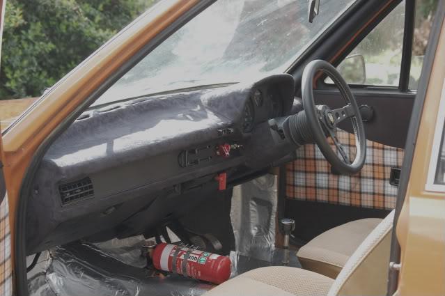

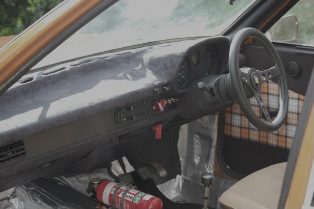

                              Little update. I decide to tackle the dashboard. Went to spot light and grabbed some suede. Looks light quality material as well. Seems like it wouldn't have any problem with breathing. Not too sure how it will handle the sun in regards to fading but I will a sun shade on the windscreen most of the time. Cleaned up the dash as best as I could but I could only do so much without spending heaps on time on it. Being a daily vehicle I couldn't afford to have the dash out for too long. Covered it with a thin foam backing fabric and then the suede. Pretty certain I wont be doing another anytime soon haha. But Im happy with the end result. It was a nightmare to make the fabric wrap around the instrument cluster
                              There is also big water leak in heavy rain so I borrowed some Wurth Windscreen Adhesive from work and sealed the gaps from the rubber to the glass. Still waiting for the sealant to try so haven't been able to properly determine if that is the cause of the leak. The Wurth sealant is excellent stuff though! I would definitely recommend it.
                              Does anyone know of a decent auto carpet dye?
