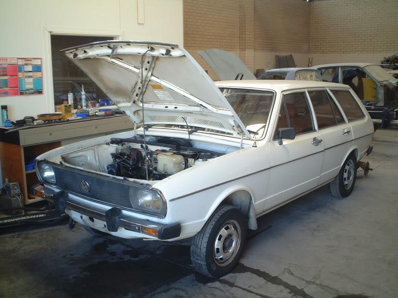

    Well we started the repairs to our Estate today. Plan is to replace motor with one from our donor car, repair a few minor dents & repaint. Lots of small thing need to be fixed too, dash clock doesn't work but we have spare, replace hand brake cable and maybe reupholster interior. Hope to get the car back on the road again a.s.a.p

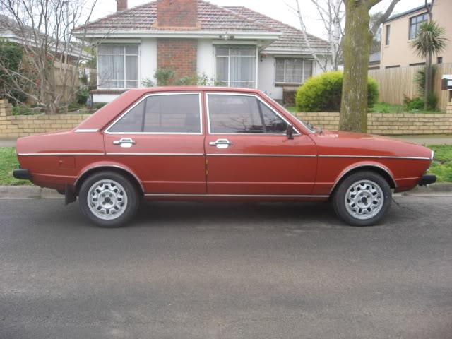

          The car is original paint, last owner had it for 18 years and was sad to let it go. He updated to a new Volvo Estate. I have never owned VW before, but thought this too good to let go. I'm restoring it for my daughter and she is helping with the resto. Were going through everything, CV boots, seat track rails and even the dash clock. It's going to be her ever day driver so I want it to be in perfect order. Luckily I found a donor car with lots of spares too (1974 4 door hatch) on ebay which had been in a shed for the last 20 years with only 98K on the clock.

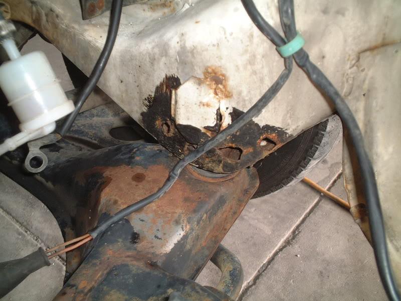

                    Thanks for all the positive comments everyone, as I'm new to VW's it is a learning experience every time I undo something. Pulling the motor out was straight forward. Luckily with the donor car we have replacement head lights, spare parts for repairing our seat track rails as there worn. As for rust, under the plenum is really good condition. There is some small rust holes on the passenger side-sub frame where it bolts to the engine cross member. With the motor now out this will be easy to weld up. The car is almost rust free, a little surface rust under the drivers door and a little above one of the side chrome moldings. As we are painting the car, I'll remove all the moldings, bumpers and door handles to get a good look under everything and a nicer paint job too. We are going to repaint it sky blue in Acrylic, as I don't have a booth at my workshop.

                        Well some update pics, the work has started and don't you just always seem to find more to do.....

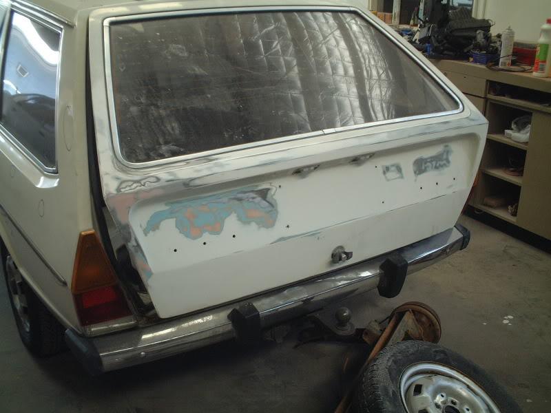

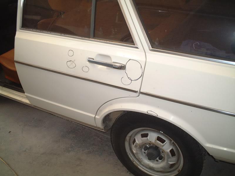

                        A previous repair to tailgate, paint had crazed so repair it again
                        Rust in the sub-frame to be removed, plated and welded

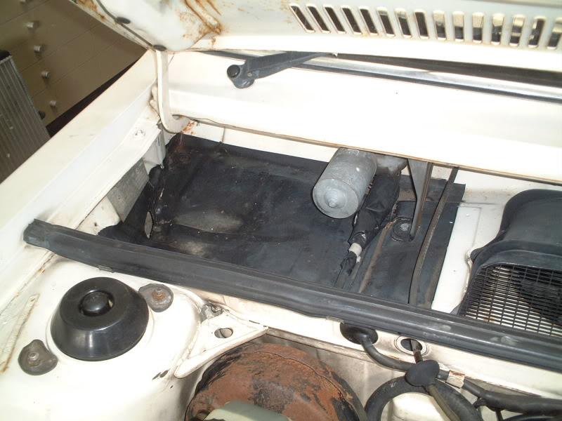

                        A good looking plenum chamber

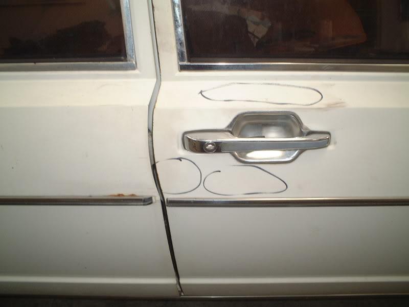

                        Not that noticeable when white, but you'll see these dents in blue

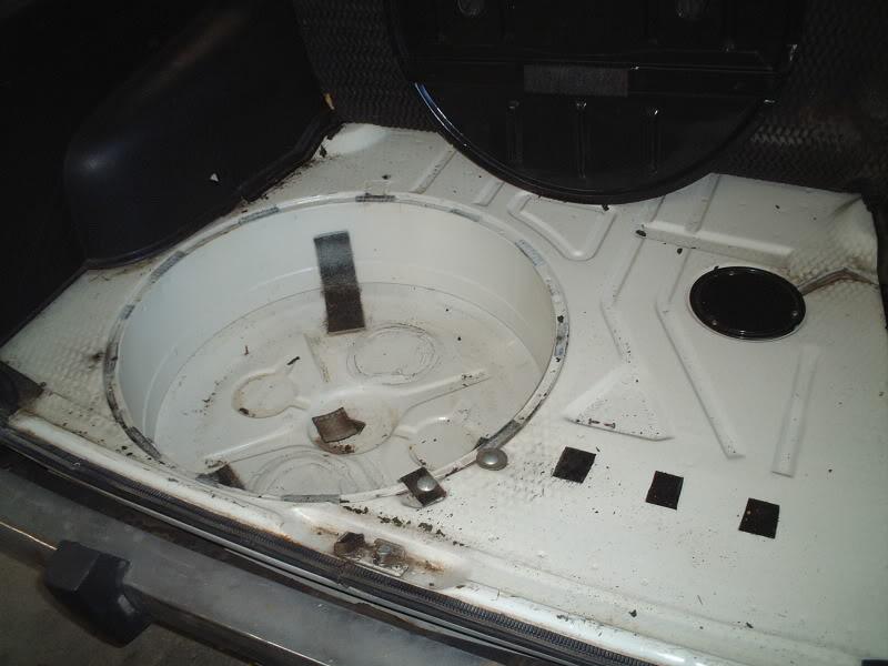

                        If under boots an tire wells all looked this good...
                          I agree the plenum area looks good but I strongly suggest that this area be checked from underneath, particularly above the fuse box.
