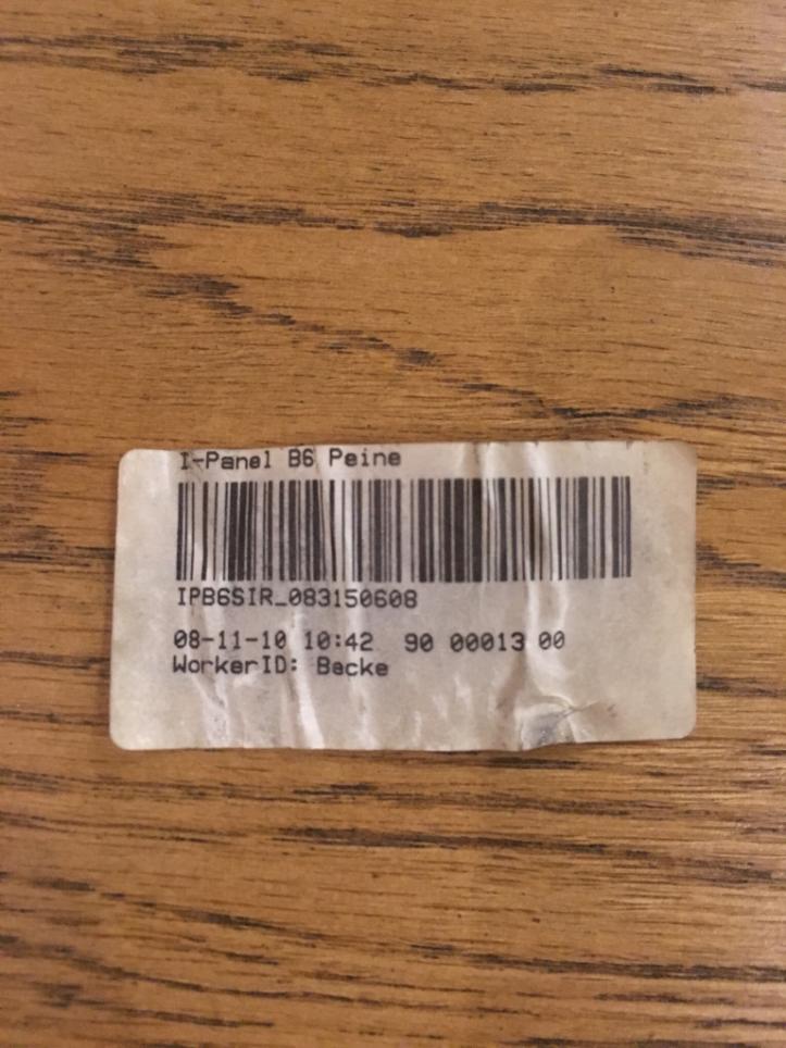

                Took the opportunity to have a look at it myself this afternoon. **** of a job removing the glovebox, a lot of jiggling and swearing. Anyway, managed to remove the blower motor and this was inside. I'd say Sydney's hot weather over the last couple of months affected the adhesive and it's fallen in from up higher.
                  Saved yourself $650 - that's a result!

                      Certainly is a result.. It makes me wonder though, did they inspect it properly or just start the car and run the AC and listen to the noise. FYI I was quoted $125 for a blower motor from a wrecked Passat with 80k on the clock so there is an affordable fix if anyone else has the same issue. 30 minutes and the work is done.
