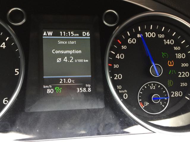

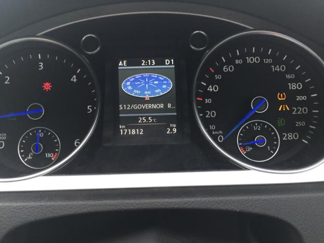

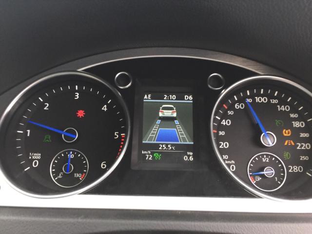

    Also yours been a 2009 you may not see the battery level and media icon on the MFD when on the phone menu, it may appear as square blocks as the MFD or instrument cluster is running older software before those features were introduced. I had this same issue with my 09 CC but then upgraded the instrument cluster from white to Colour and it now displays battery level and the media icon. No big deal tho as it functions fine

          Awesome .... Also you got any pics of ur instrument cluster ? I am interested to see what it looks like
          Sent from my Nexus 6 using Tapatalk
            Here's some pics, I may be selling it in a few months if I can find a 3D diesel one.
              Looks awesome . thanks for the quick answer .
