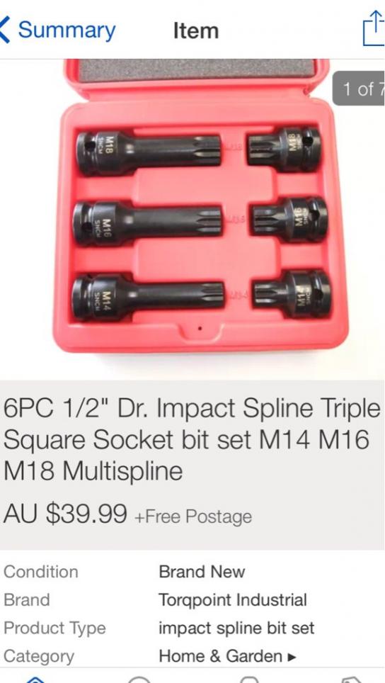

FYI- if you are changing the rear disc's on your CC, you will need a 14mm spline head socket to get the caliper bracket off which will allow you to get the disc off. I bought mine here: http://pages.ebay.com/link/?nav=item...d=131190074891

This is a pic of the tool for the rear in that eBay link I listed in the last post. The M14 is the one required for the rear, but I heard the others are used on other suspension components on VW's and Audi's, so the kit may come in handy:
