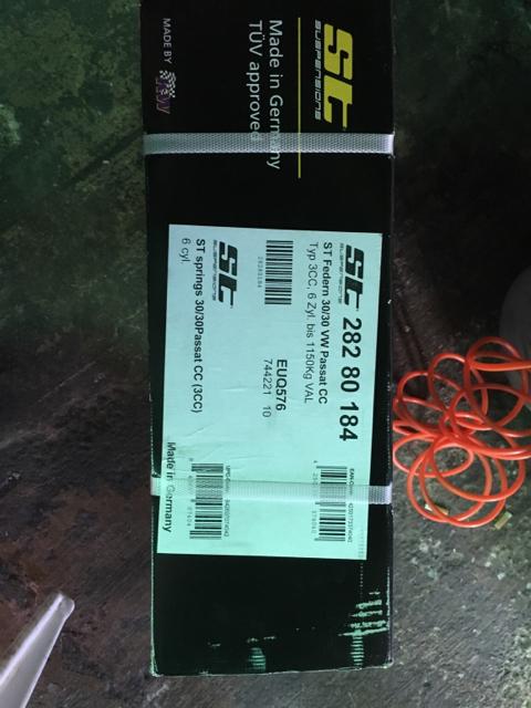

        • look what came today
          goin in next week , will post up some photos when they go in !

              these should lower the car by 30mm f+r
              they seem to be the lowest springs available from a reputable suspension company

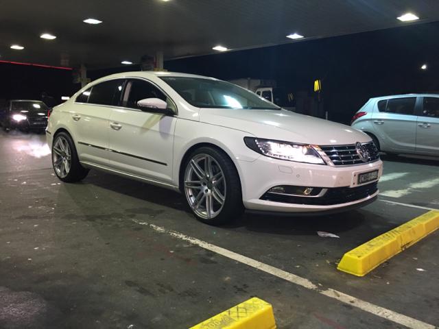

                        • cheers ryan - got my new rims put on pic below . i think i may need lower profile tyres as the rears seem to scrub when i go over bumps ! imagine after i lower the car [emoji33]
                          think im gonna get some guard work done on the weekend ..
                          • Nice man they look great! What profile did you end up going?
                            I think a 30 profile is what you may need to avoid the scrubbing

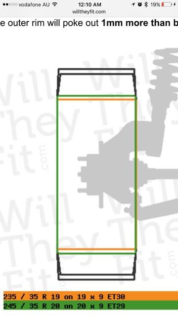

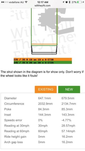

                              i bought the rims with tyres, theyre oem audi 20's that came with 245 35 20 =/ you think i should go a lower profile ?
                              • What have you done to your CC Today?
                                I think that would do it. Comparing to my wheels which don't rub, you have 1mm of extra poke because of the offset but the profile increases the size a bit, also the 245 sits wider on the tyre then a 235 which is stretched. Check out this diagram, mine in orange yours green:
