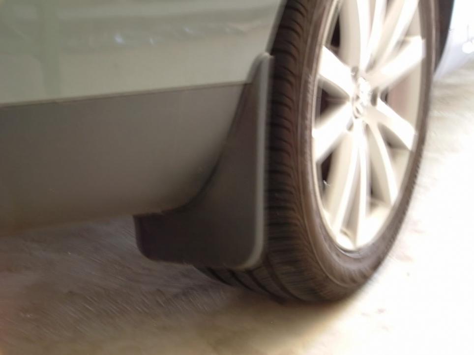

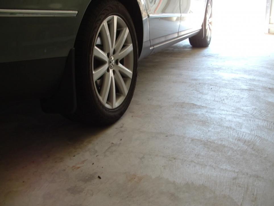

        I own a 2007 Passat, brought some from a Hong Kong eBay seller for around $30Aussie, which included the postage. Unlike the ones on OEM, these are a hardish, moulded plastic, made to fit the side profile of the car. Took me about half an hour to fit, only had to drill one hole on each side for the front mud flags, did not even need to take the wheels off, and just turned them away from the area that I fitted them on. They do have a little flex in them as I have back up to gutters with them and not had a problem.
          Just thought I add some photos to show what they are like.
            Try a second time.

                              Mud Flaps are on, fit really well, took about 1 hour to do all four.
                              The front ones required me to drill two small holes into the black plastic cover inside the wheel arch, to fit one screw on each side. This extra screw is really just to locate the flap as it would not be doing much to hold it on. An existing factory screw was used to do the main securing of the flap. I was able to turn the wheels out of the way, therefore I did not have to remove the front wheels.
                              The rear wheels had to be removed, but I did not need to drill any holes. Two existing factory screws were used to fix it in place.
                              The flap is molded in the correct shape to fit the body and wheel arch.
                              Overall very happy result, and the money I saved.
