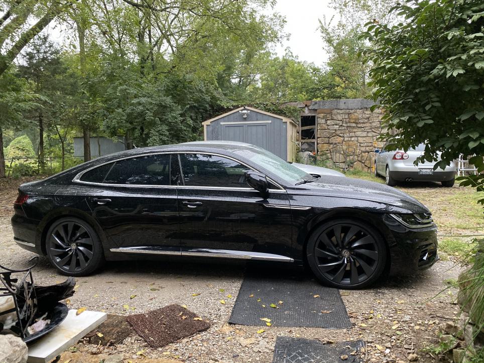

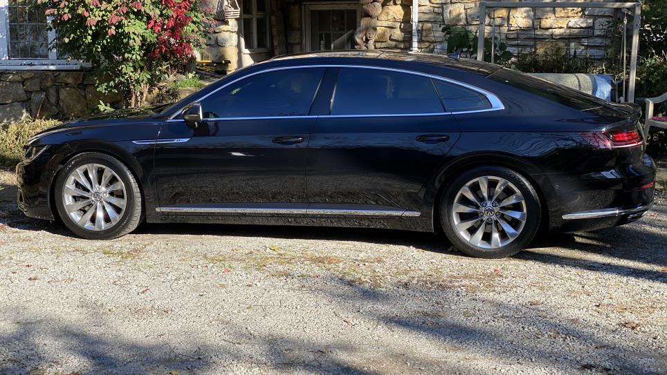

    Eibach Pro kit - what it looks like on 18’s and 20’s
