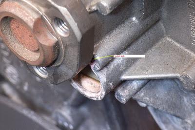

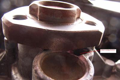

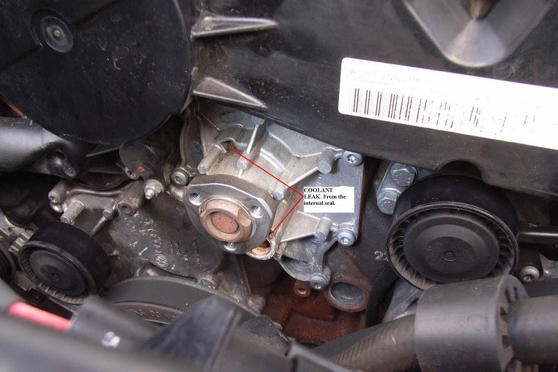

In past 12 months I had to top up almost 2L of the coolant. After the closer inspection of the engine bay I found pink spots on the front of the engine.
There is not much you can see unless you remove the water pump pulley.
So, fellow Tregers check the coolant level on regular basis and if you have to top up keep the record. Touareg has a closed cooling system and if everything is OK there is no coolant loss due to evaporation, like in some other cars, where the coolant reservoir is open to the outside air. Don't rely on dealer that he will tell you that they had to top up coolant, they could forget to tell you.
