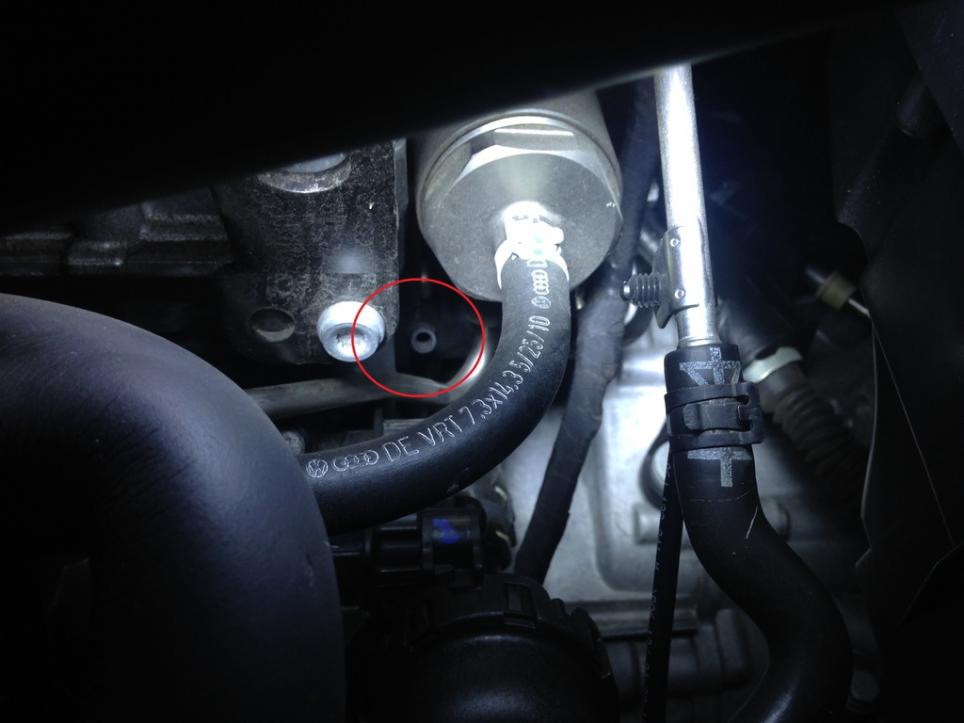

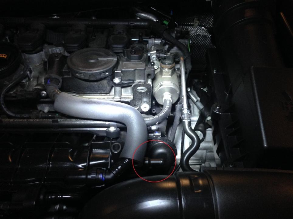

    I have intake manifold flap and misfire codes. I had a look around and it looks like i am missing a hose or two? Should there be anything attached to the two areas circled?

    Just checked and mine doesn't have any hoses attached to the 2 pipes you have circled and doesn't throw a code.

        Thanks guys! Google helped me out and confirmed I'm not missing a hose. I'm almost positive the misfire is due to dirty intake valves as its on 78k.
