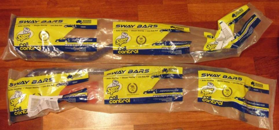

      My new Adjustable Super Pro Swaybars just arrived for the wife's Tiguan.
      I'll be fitting them on Sunday when I give the car it's first service,so if anyone on here is interested in the rear 24mm adjustable bar that's coming off of the car,please let me know.

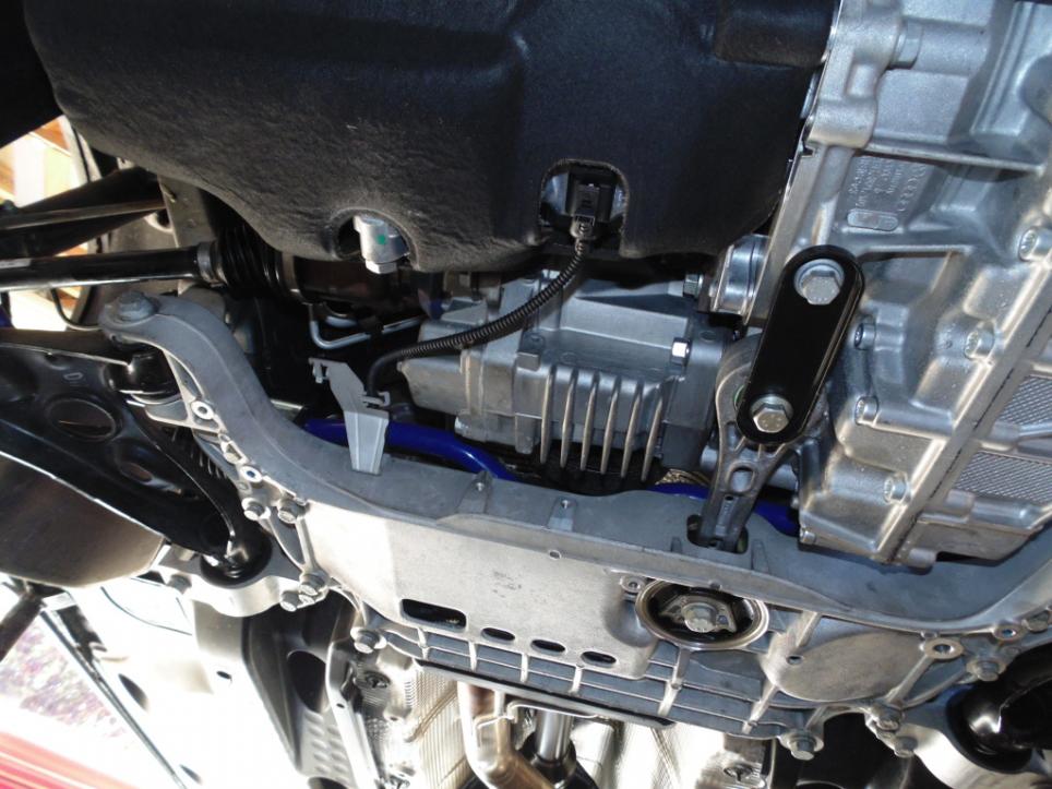

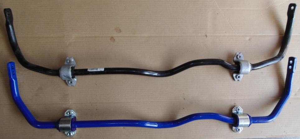

        I also swapped out the 24mm Super Pro Adjustable Rear Swaybar I'd previously fitted for their 26mm bar,and fitted their 24mm Adjustable Front Swaybar.
        The front bar is NOT a simple job as it requires removal of pretty much the entire front end from the car due to the one piece cross-member design.
        I'm a qualified mechanic,and doing this job on my own on the floor of my garage was NOT fun,nor simple like the rear bar is. The car will likely require a wheel alignment afterwards and there is the potential to damage wiring and the steering rack if you're not careful so I won't be posting a step-by-step DIY walk-through for this job. I will however post a required tools list,and some photos of the job as I went through it.
        I got away with only requiring a minor front toe adjustment as I was VERY careful with how I marked the assembly's position prior to removal and made sure it went back into exactly the same spot. Getting the steering rack to sit in exactly the same spot on the cross-member isn't as easy however,so I needed a 1/4 turn on each tie rod afterwards to square the steering wheel back up.

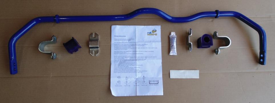

        The kit as supplied by Super Pro. Note the meaty new D bushing brackets. These ones aren't going to break,unlike some other brands,and you don't have to drill out your old brackets from your original bar either,which saves time and keeps your OEM parts intact.
        New bar assembled and placed next to the original bar for comparison. The OEM bar is 1mm thinner than the Adjustable Super Pro bar at 23.5mm.
        Cross-member & Front LCA assembly on the ground,with the new bar installed.
        And back together.
        So,the verdict? Worth the effort. The larger rear bar made the most difference,but even with the front bar on it's softer setting,the difference up front is noticeable. The car sits beautifully flat now on the quick punt around a few local roads I took it on after the job was done. Even on the stock 16's the car easily out-handles my Lexus.

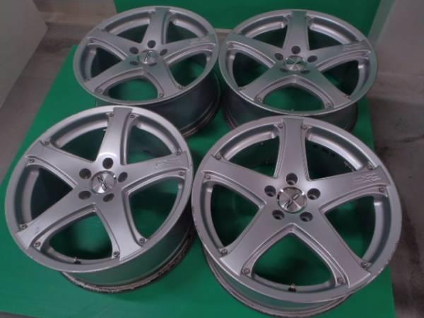

            Pic of the wheels from Japan:

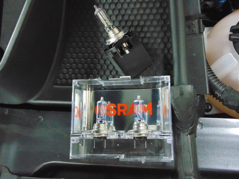

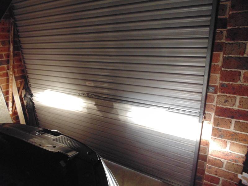

              Fitted some 'cool blue' park light globes,and a pair of Osram's 'Nightbreaker Unlimited' H7 headlight globes to our Tiguan yesterday afternoon.
              They claim a 110% increase in light output compared to a normal globe,and in this case,the difference is immediately noticeable,much clearer light,and a better spread than the OEM globes (which are also from Osram BTW!).
              These retail at $73.00 a pair (although I can supply them for better than that ).
              New globe fitted on the right hand side...
