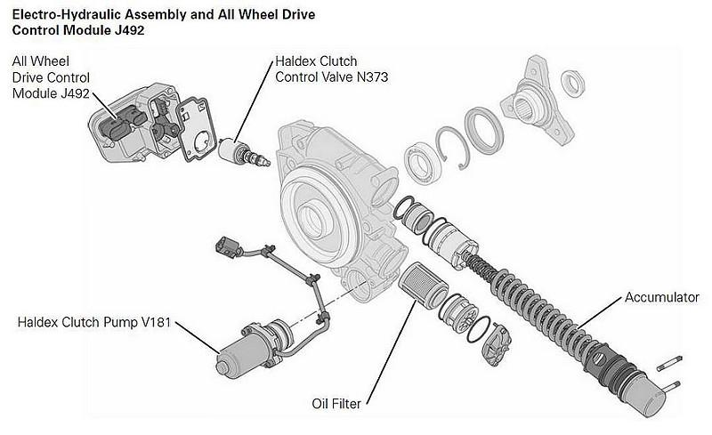

          Saw this Gen4 Haldex filter on Nuespeed: Haldex Gen 4 Filter Replacement Kit
          Also available from a couple of other places including HSTuning: HS Tuning - Haldex Gen 4 Filter Replacement Kit - HALDEX.111358
          Looks like it's suitable for the Tig. Maybe next oil change....

              Tigger73,
              The following pdf might show you a bit more about the filter - see page 12 onwards for the diagrams:
              http://www.freel2.com/gallery/albums...aldex_gen4.pdf

                In case the link goes down or perhaps you're like Ramee and like taking things apart here's the exploded view showing the control module, filter, pump and control valve.
                  haha! This may come very handy for me
