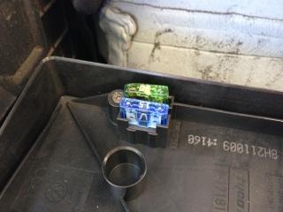

    Your Ebox fuse board will have melted...the fuse box next to the battery...check the 30amp fuse on the back left...pull it out..you will see it and the board melted....put a new fuse in will get them working for now but you will need a new fuse board....VDUB...

            have a check of the fuse mate...you will see if thats your issue..only takes 2 mins to check ...VDUB...

                    BTW I checked the fuse box and the top left fuse (green 30) have melted just like you said.
                    Do you know what that fuse is for?

                      Found it: F16 (30A) Multifunction control module 2
                      Is this the head unit?

                          The cause is a high current contact that has resistance, causing heating at the interface that melts everything around it. As the contact heats and becomes burnished, the resistance increases, perpetuating the problem.
                          In this case, its likely that the spring tension of the fuse holder contact was insufficient. Manufacturing problem.
                          Merely pointed it out to the dealer, they changed the fuse box without any comment, assume it is a common fault.
