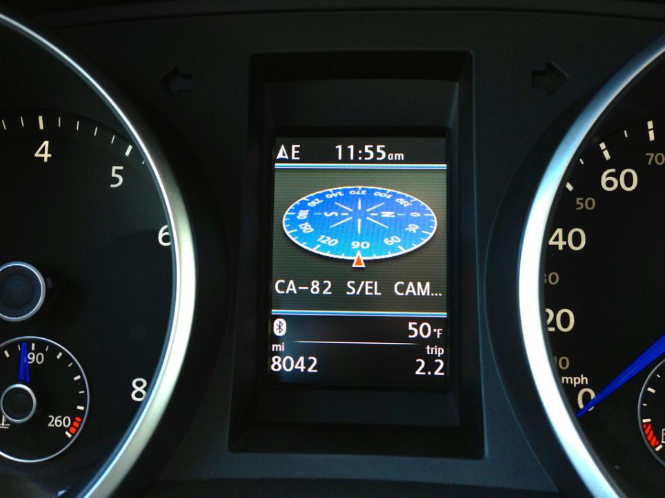

- New white dot MFD works perfect with Bluetooth 9W7 menu and new mk6 MFSW retrofit
- The contrast of the white MFD is much better
- Cruise control now shows a little icon in the MFD with the current CC speed value, and last used CC speed value (so you know what you will get when you press RES to restart the CC, rather than the press-and-pray method of the previous CC display where it was just a little green icon). I am not sure if the new "CH" version SWCM contributes to this. I changed the SWCM from BG to CH with the mk6 MFSW steering wheel retrofit.
