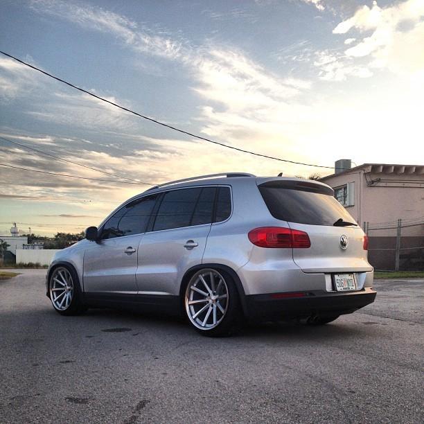

    Are you looking to go to something like this?

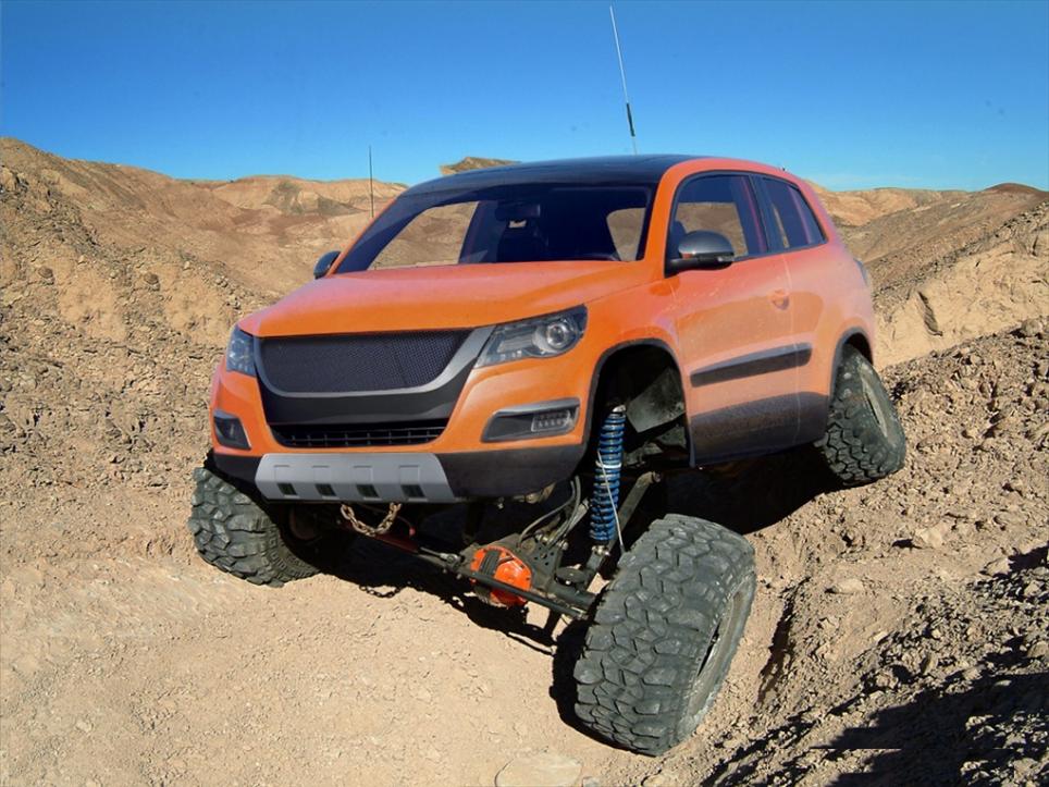

    Or perhaps this?
    Obviously set-up is different depending on what you're looking to achieve.
    ...and also depends on your budget of course!
