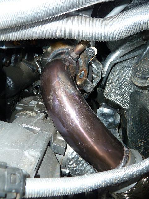

    OK so the downpipe is 2.75" at the front going down to 2.5" and the back and gets rid of the massive restriction right after the turbo.

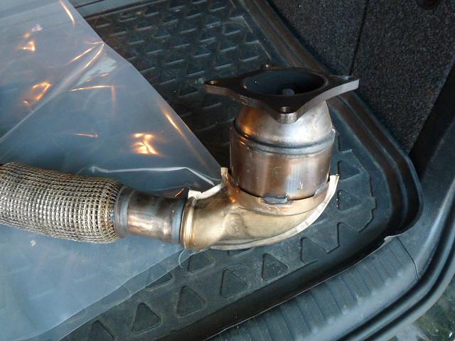

    And for comparison here's the stock DP:

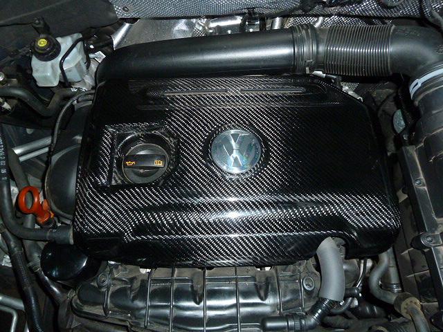

    Also some additional "bling" under the bonnet - a carbon engine cover.

      That standard downpipe is dire, VW should be ashamed of themselves

        Not really a fan of the cover. Kinda clashes with everything else.
        I definitely look forward to the project though. It's gonna be a good one!
        Sub'd
          That's fine, more carbon for me.
              Sub'd
              Even though it may look a little out of place at the moment, there's another reasonable sized chunk of carbon going in there shortly (CAI).
              And I understand that for those looking to complete the set there may even be a battery cover coming out soon.
              - Tigger73's 125TSI Build
                That seems more the go than just an engine cover. One just kinda looks out of place, glad there's more Carbon to come.
                  Gavin
                  Yes it does need some TLC. Though I do a reasonable amount of driving on dirt roads so it's going to go back to looking like this pretty shortly anyway.
                  And agree that the stock DP is a bit of an enginering monstrosity - though it's probably built that way to be tight on emissions and for cost considerations. Though unfortunately performance goes out the window.
                  With the new DP on it runs so much freer at higher revs. Loving it.

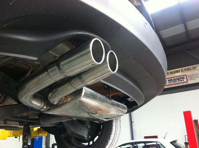

                          Actually there was a pre-production twin exit on my car but got taken back off as they needed to use it to build the production unit.
                          Sorry I can't tell you what it sounds like as I wasn't there during the test fits
                          Release for the twin exit is soon (hopefully by the end of the year). Though there is also a new rear diffuser on the cards so it may get released when both are ready and likely the rear diffuser will be the thing that holds it up.
                            Twin exit means left and right side?? Now that may change my mind...
                              The quality on that exhaust looks superb.
                              Nope twin exit is what you're looking at which is 2 separate tail pipes on the rear left side.
                              What you're talking about is a quad exit - 2 set of twins so 2 exits on both left and right sides.
                              This is a little tricker as it means that you need a new rear diffuser. There's a cut-out on the left side for the tail pipes, but nothing on the right.... which means you either need to cut the plastic (which would look crappy) or create a new moulding with both left and right exit.
                              I believe this may be happening but still waiting to hear if this is going to become a reality (fingers crossed).
