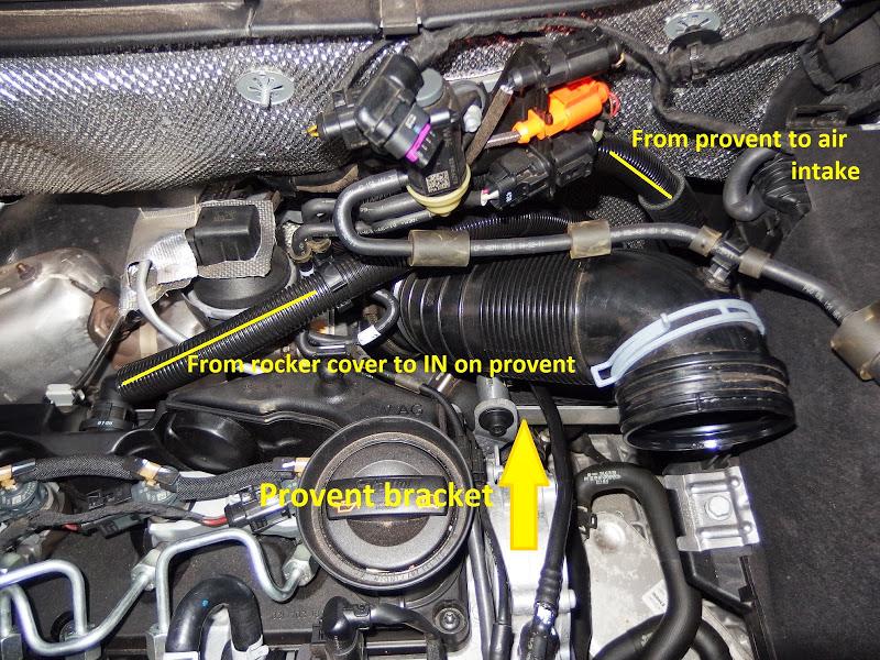

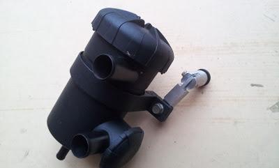

      I hear you guys, I'm quite busy at the moment, but didn't forgot on you. As I mentioned earlier the Provent is fitted between the engine and the battery, it's bolted to the bracket that attaches to the engine. The bracket is adjustable, it allows positioning the Provent, so it doesn't touch any other hoses or components there. The first bracket I made was fabricated from 25x2.5 flat steel and eccentric washer like insert, but I wanted the bracket to be kind of universal (at least for all 4cylinder TDI's), so I made it in lathe from the marine grade aluminium.
      The flat steel bracket with provent fitted in the place.
      There is no need to drill any holes or relocate anything in the engine bay, after adjusting the bracket with the Provent, tighten up the bolts on the joints. You could even use the epoxy in the bracket’s moveable joints to be sure it doesn't change the position (highly recomended).
      Now, you only need to figure out the hoses. Anyone with the Tiguan TDI can get the hoses from me, they aren’t cheap, but are easy to fit and will not come off (if fitted correctly).

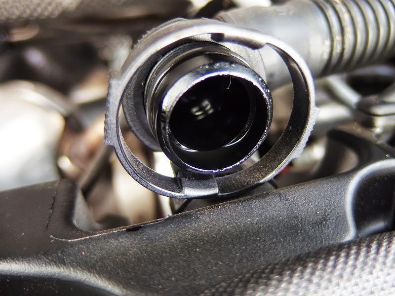

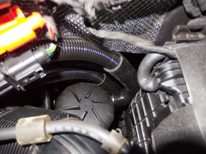

                            The Provent200 test fitted to 2012 Tiguan TDI, it also fits to 2010 and previous TDI Tiguans, as I have tried it in both our Tigs.
                            The hose is oil resistant and for the temperatures up to 120deg.Celsius, so it should be all good. I've fitted the same hose to the Provent200 in my T5 a months or so ago and it's so far so good.
                            That much of oil has accumulated in the pcv hose in just less than 8,000km and 15months of daily short trips;
