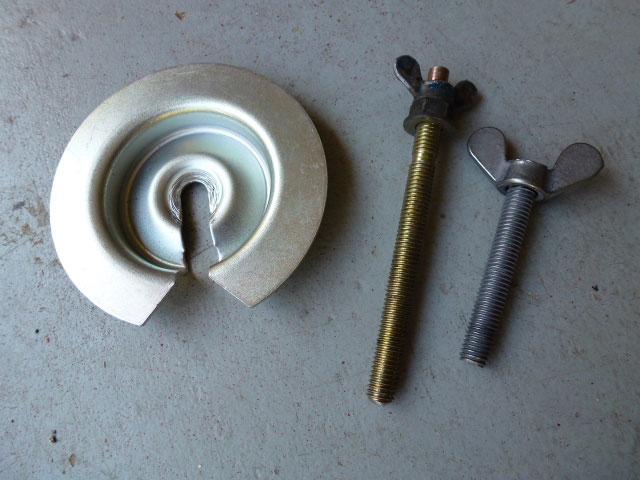

      Securing the wheel is easy with a longer bolt - using M8 threaded rod, nut and wing nut like the one on the left:

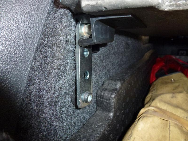

      If you keep the original rear floor, and let it sit 70mm higher, you either need to relocate the side pins that secure the front of it, or extend the pins. I tried the latter but it's a bit cluncky - works OK but the two extensions I made up can fall off, and the tailgate just closes flush with the floor in an elevated position. I also used two velcro strips to hold down the back end but the velcro doesn't stick all that well to the Tig's carpet.

        Fitting it in the wheelwell went OK - as others have noticed, the floor sits up higher, but I bought 2 of those cheap blue luggage straps and wrapped them around the removeable floor and thru the tie-down loops front and rear. Holds it all secure in case of accident. The wheel bolt that secures it to the chassis is too short, so I bought a Bunnings bolt.

                I left the original wheel cut-out and installed a full size spare with Phil G's "special" threaded rod/wing nut/nut:

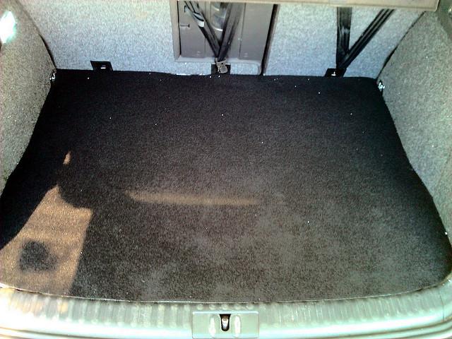

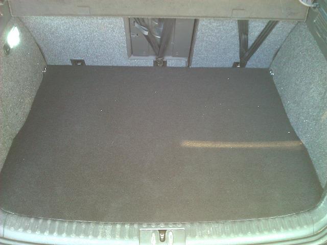

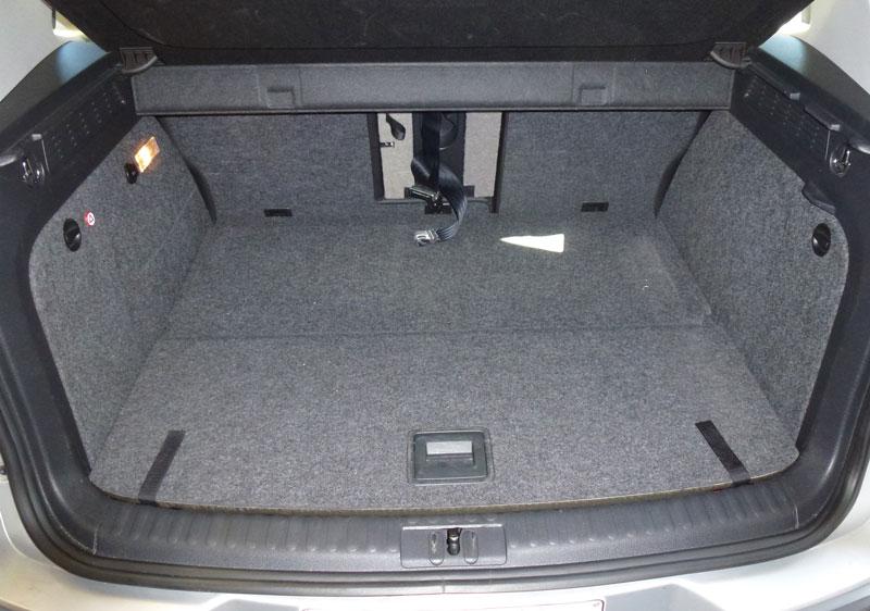

                            OK. Here's a few "before" and "after" photos.
                            Original is just for reference with the space saver (stock):
                            Now with the full size wheel and the original flooring sitting on top:
                            After mods:
                            Here's the boot lip level view with full size wheel and "orginal" floor sitting on top:
                            And after fitting the new floor, the carpet now sits just under the height of the boot lip:
                            So it was a bit of effort but for around $300 I've now got a full size spare(second hand) and new boot floor. Certainly a worthwhile addition given that I do a fair bit of country driving and the occasional 100km on dirt.
