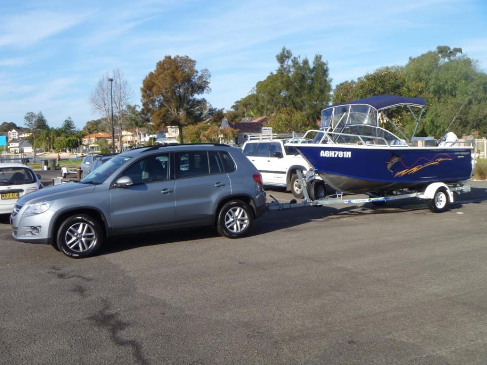

                    HI Guys,
                    Just towed a Quintrex Freedom Cruiser 570 from Forster, to Sydney southwest, around 400km. Boat and trailer weight around 1200kg, I was very surprised how well it towed, I didn't try break any speed records, Cruised at around 105km/h the whole way. There were no problems getting the boat out of the water, of getting up the various hill climbs of the freeway.
                    2012 Tiguan| 132 DGS |Deep Black Pearl|Comfort Pack|New York Alloys|Tow Kit.

                        Ganue,
                        Might want to check your tow ball weight that the trailer is pushing down.... looks like it might be a bit heavy... I had to move my boat back on the trailer 100mm and the axle forward 80mm to acheive a 75kg towball down force.... before doing that mine had 150+kg downforce!! (the Tiggy's are rated for 100kg down force).... the boat yards don't really care too much about the correct balance or COG (centre of gravity) when they sell us our new toys.
                        Tiggy 125TSI, 6 speed manual, tints, comfort pack.
                          Thanks I will check it out
