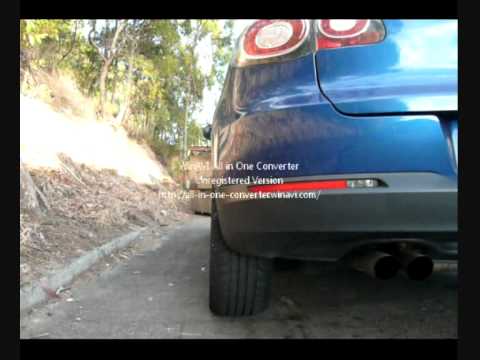

    I fealt the same but it was too difficult for me to be bothered so i just got them to remove the whole rear muffler and put a mandrel bent 3" stainles steel delete pipe going to twin Xforce tips.
    Sound Clip can be found here:
    Now it can be a bit loud on wide open throttle so i would suggest if you want a subdued version that you look into a resonator delete as this will retain the muffler but net you a more burblier note while still retaining a muffling section as well as losing the most restricive flow section of the cat-back.
    Nindey has done his however I am yet to get a video out of him to compare.

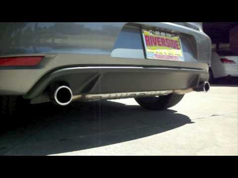

    This is the closest i could find for you:
