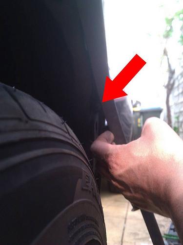

      4. Remove three T25 Torx screws from the front of the wheel arches (one of them is a bit hidden under the protective covering - I had to muck around for ages looking for it).

          Just in case you're trying to locate the "hidden" torx screw, I've had my front end off and eventually found it under the front guard. Here's a picture in case you need to remove your front bumper:
