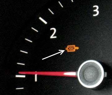

                I highly doubt you have DPF issues, as if it clogs if goes into limp and puts up a different light that looks like a DPF from what I've read, rather than the engine shaped light I certainly see my share of ( but I'm usually the cause of... ) This isn't the exact one, but you get the idea....it's not your typical light:
