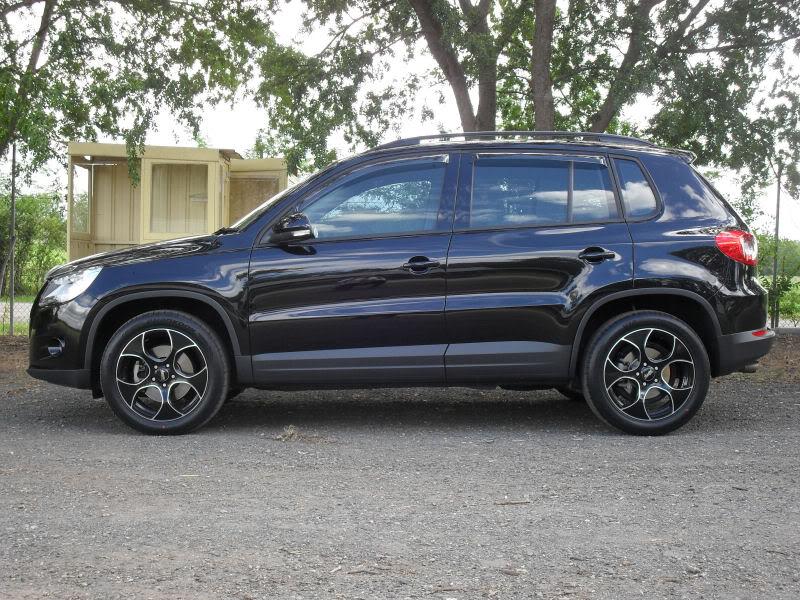

              I have posted pics before under the heading "new wheels" about a month ago.
              I had trouble putting the pic on, so I dont want to try doing so again and stuffing anything up. If you would like to see the wheels, please look back on that previous thread.
              I am really dissapointed, as I really liked the wheels. (advanti concepts. on a black tiguan)
              The wheel rep is going to be contacted on monday, to see what the real issue is. I hope it can be resolved, as I would like these back on if possible.
              I still am leaning toward the bolts being the issue. They are not tapered like the originals, and I feel that they are not securing the wheels properly, or coming loose somehow.
                Will keep you all posted. Thanks for the helpful suggestions too!
                There might be your problem! With the tyre fitters like these some one will get killed one day with the wheel coming off.
                You have to always use the right bolts.
                  And here it is:
                  • #24
                    Hi Spook,
                    Thanks for re-posting my pic. I wasnt sure how to do so. Appreciate your help.
