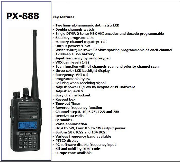

            Consider the Puxing PX-888 D model, you can pick them up for $100 from ebay with the programming cable. They're 4 watts in UHF mode and you can plug in external antennas. Excellent units and you can buy kenwood mics for them ($5 for a remote mic/speaker for example) and other bits and pieces cheap.

                  Maybe because UHF has a lot of applications, I have a UHF 4W handheld one in the car (mostly for gtg's and trips around SEQ so it's generally turned off) and it's handy to hear traffic updates, police warnings, updates on vans with dark windows "broken down" behind bushes and if you get stuck without mobile coverage (believe it or not mobiles don't cover all of Australia) you can use the radio to call for help.
                  So tell us why wouldn't need a UHF these days?
                  And for a $100 you get all the features below - a small price to pay even if you rarely use it given how handy it could be.

                      I can't see it in the specs for the PX-888 however they have a PX-333 (new model) that has it listed - http://www.pxdz.com/english/showpro.asp?id=2371
                      The PX-888 specs are here - http://www.pxdz.com/english/showpro.asp?id=2362
                      (the website shows the uhf models as finishing at 470MHz but they have a version D of each that goes to 480MHz for Australia)
                      Feature for px-333
                      5 tone selective call OPTION( CCIR,ZVEI EEV,EIA etc..)
                      Scrambler IC OPTION(Plug & unplug easy)
                      Select call and group call
                      Adjust the CTCSS by software.
                      Adjust the power by software.
                      50 CTCSS and 107 DCS
                      128 channels
                      Small and Compact Size: 98x53x30mm
                      Output power 4-5W/0.5W
                      Wide and Narrow band
                      Battery low power alert
                      Input frequency directly by keypad
                      Channel(MR) and frequency(VFO) mode switchable
                      Radio turn-off timer (1-15h)
                      Eight groups Scrambler built-in
                      Channel bank store
                      Battery save function
                      Busy channel lockout
                      DC voltage display
                      FM radio receiver built-in(display radio's frequency)
                      Backlight working time control
                      Keypad lock/PTT lock/All keys lock
                      Open message edit
                      Alpha-Numeric channel name
                      Repeater offset
                      Open password protection
                      End roger
                      Scan modes selectable
                      Time out timer
                      VOX/VOX delay/VOX sensitivity adjustable
                      VHF 136-174mhz/UHF 400-470mhz/465-520MHZ
                      Repeater tone 1750hz
                      The PX-888 doesn't allow direct frequency entry by keypad so you program it with the software and set up the channels. The PX-333 you program it via the keypad which I think is illegal in Australia as it can be set to transmit of all the frequencies. A minor point but still worth noting, I assume you can lock the setting of frequencies in the PX-333.

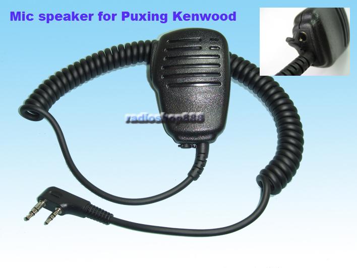

                            I don't use the handheld itself when driving, I use one of two speaker mics.
                            The speaker mic can attack the seatbelt or your shirt and it has a headphone jack as well.
                            The earbone style allows you to have your stereo on and you can talk without the music being transmitted. It works off vibrations from the bones your ear plus you can use your finger to activate the PTT so no need to take your hand off the steering wheel.
