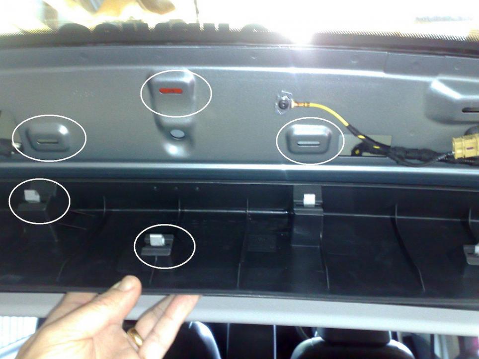

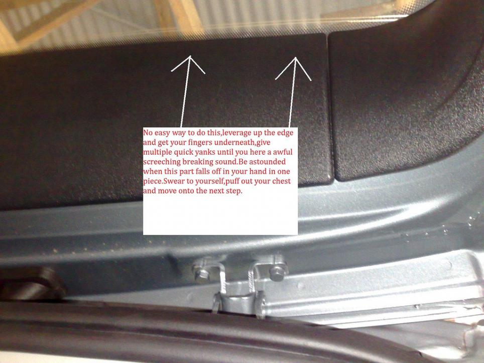

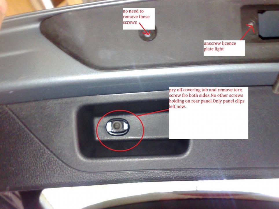

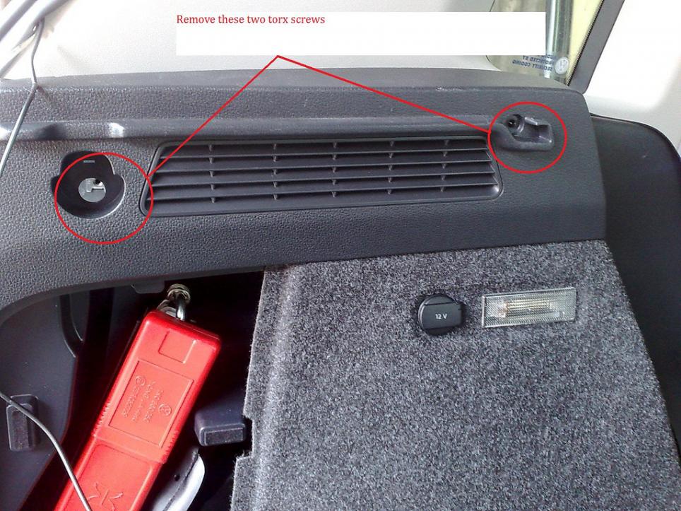

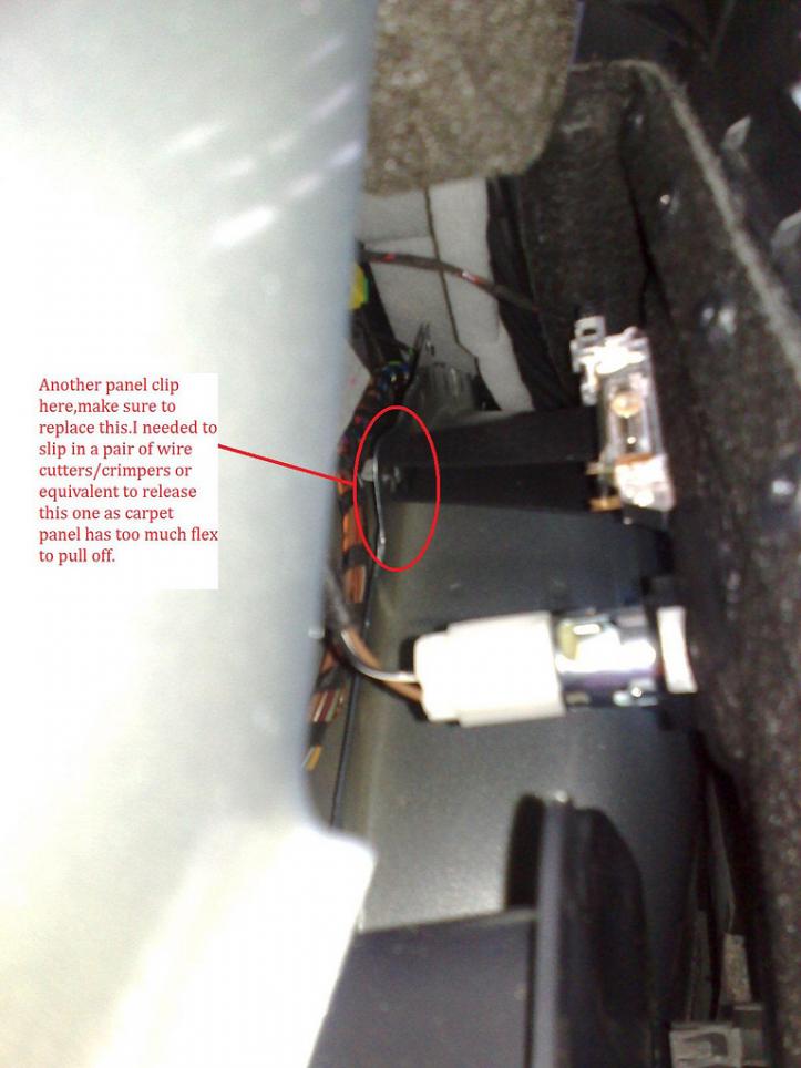

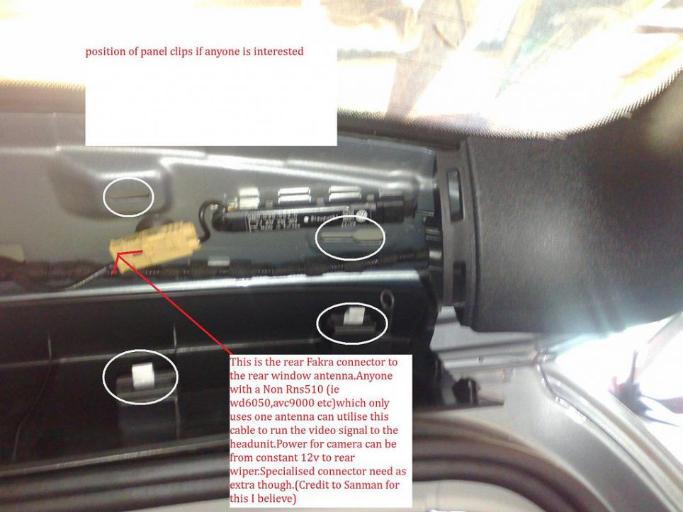

    The most frustrating part is taking off the panels which no one has ever produced a guide for the tiguan so here is my version. A panel removal tool would help but I didnt have one.Dont need one in the end so save yourself $30.
    remove the uppermost trim first
    next on the botton of the tailgate

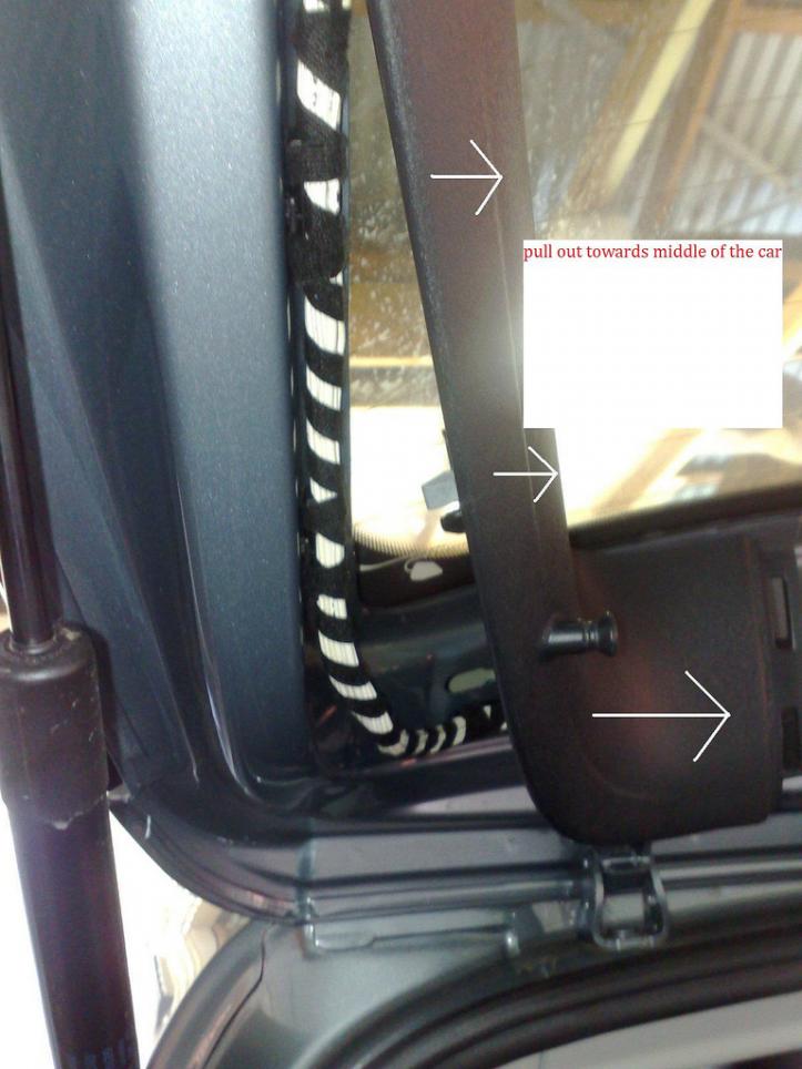

    Back to the upper trim you have just removed
    Now removed the side trim-only need to do one side,i chose left but either is ok

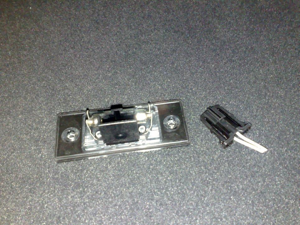

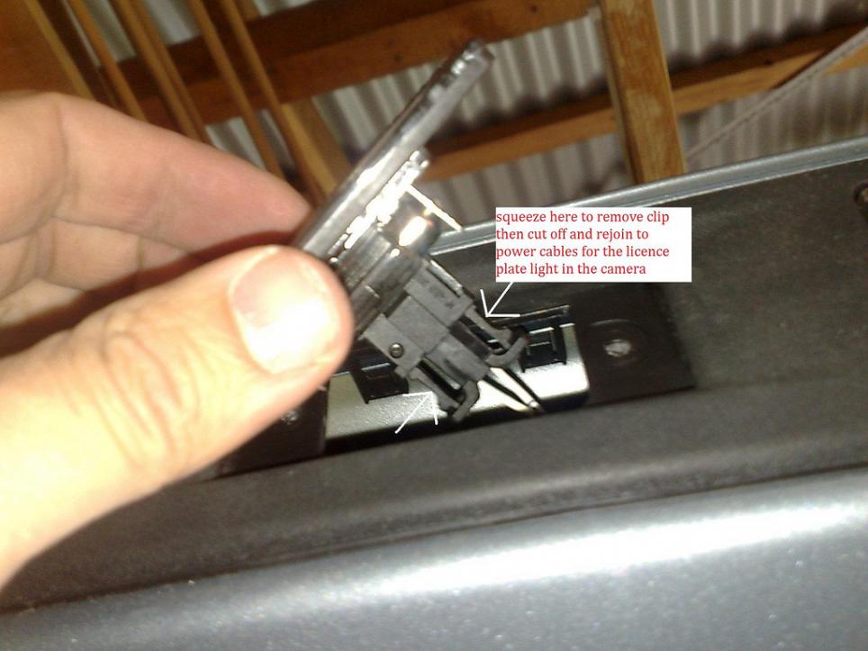

    removal of licence plate light

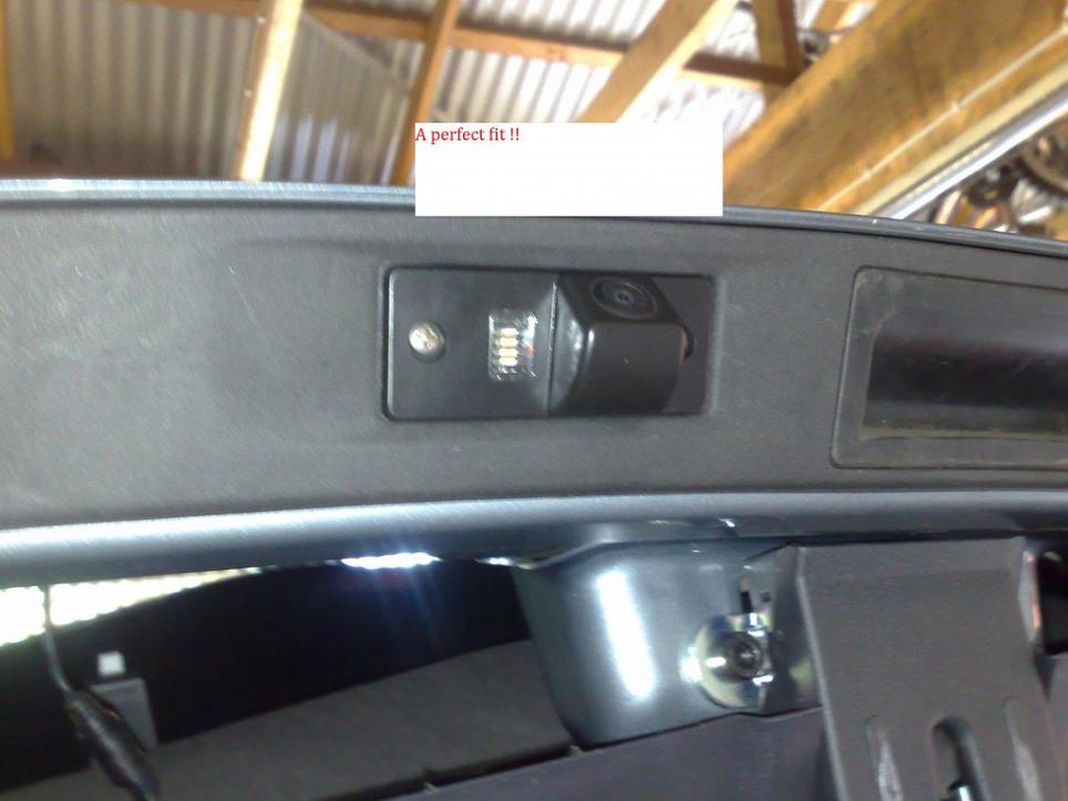

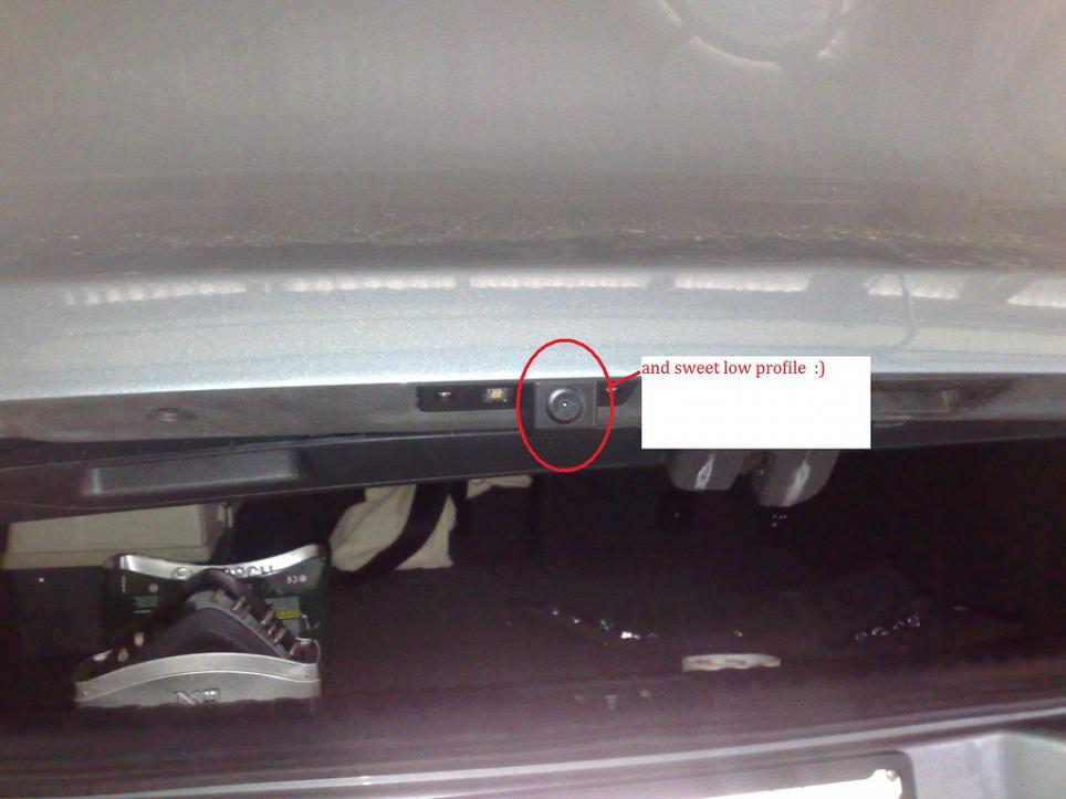

    Install new Touareg camera

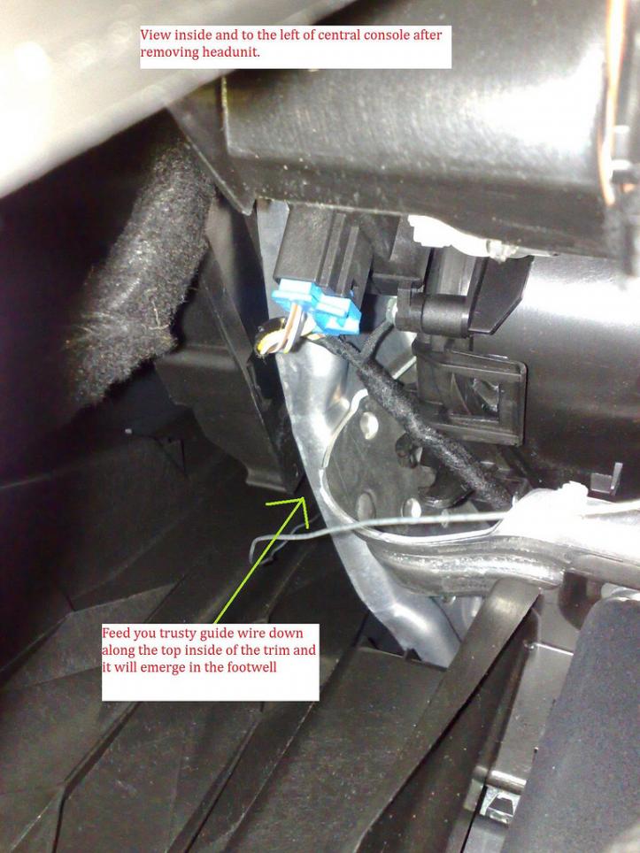

    Wiring

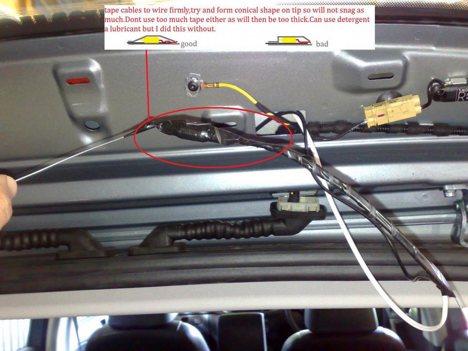

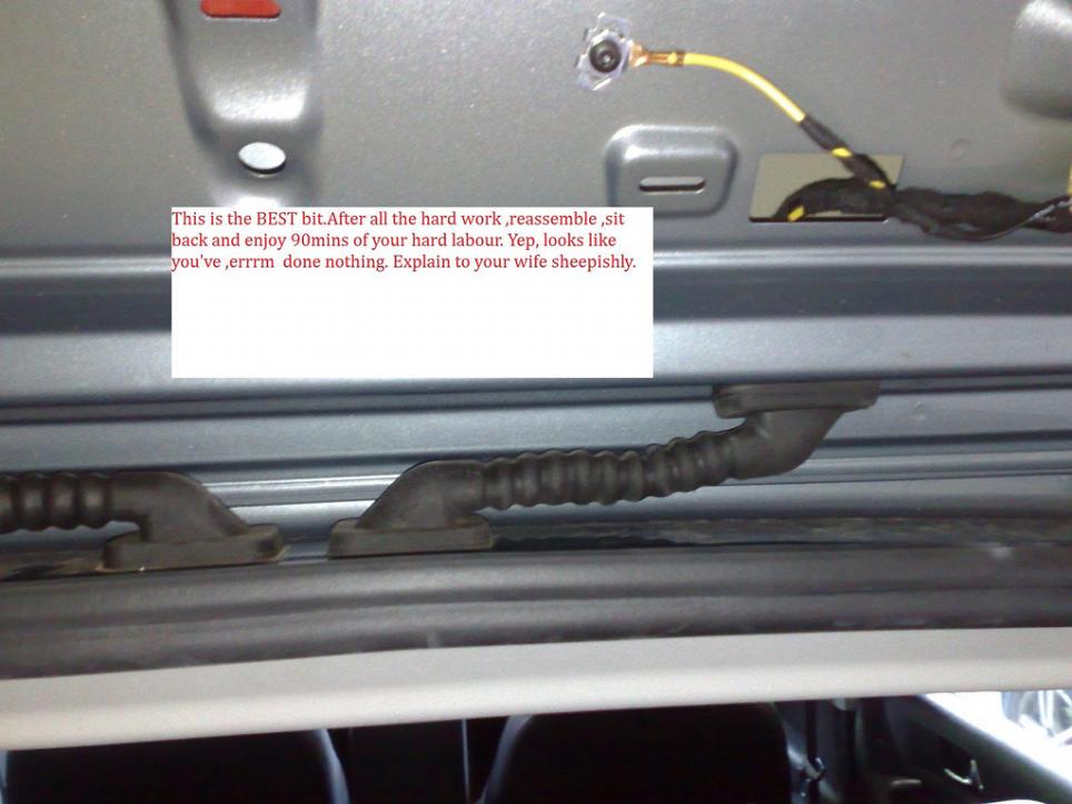

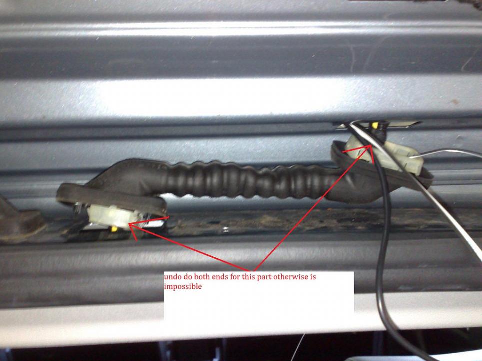

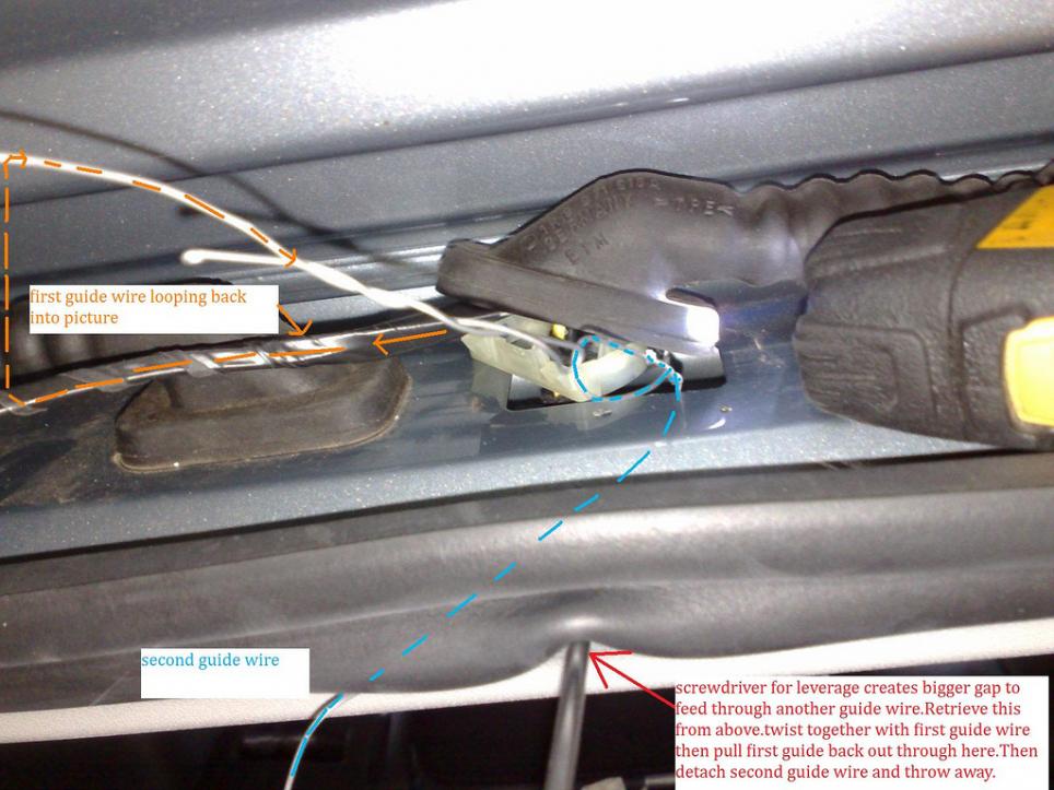

    The guidewire -thin gauge but stiff metal wire for fencing or equivalent

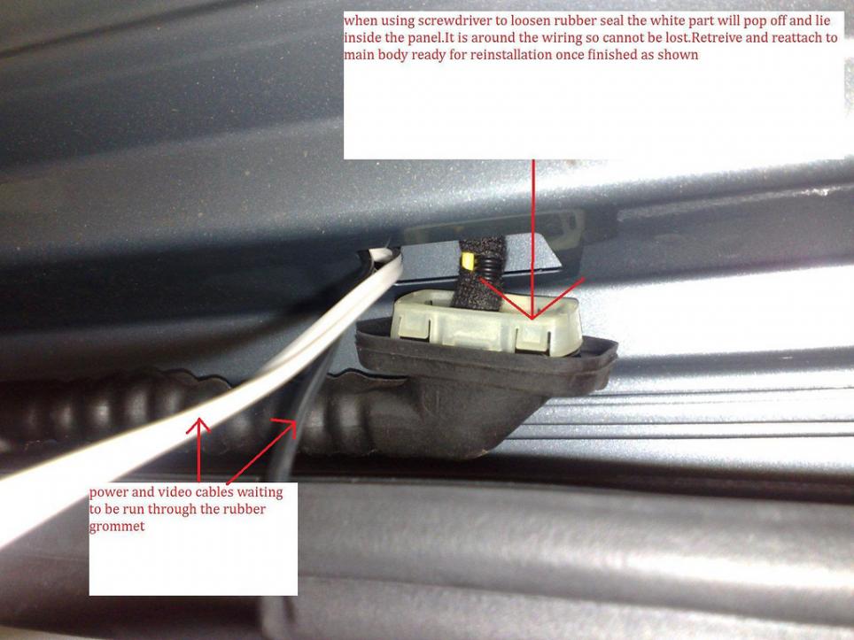

    Remember I had to replace the faulty wiring hence the video and power wires are different now

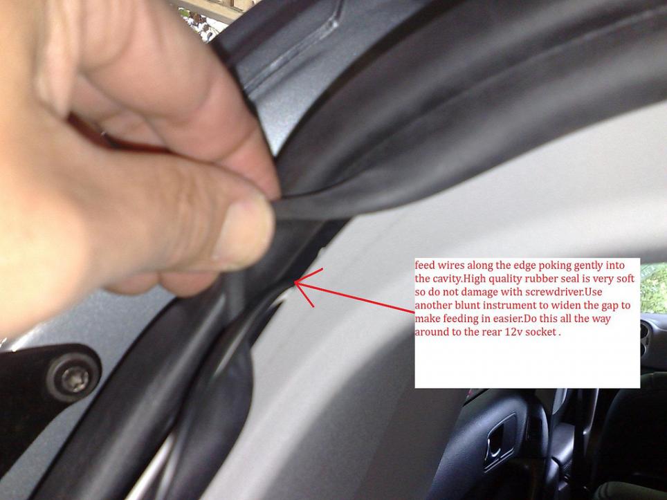

    Once you have fed it throught the rubber tube,you must then feed it back down into the roof lining.Doing this in 2 parts is necessary.Feed a second guide wire as shown forwards and up out of the hole,then attach the first guide wire and pull back so fisrt guide wire comes out from under roof lining.

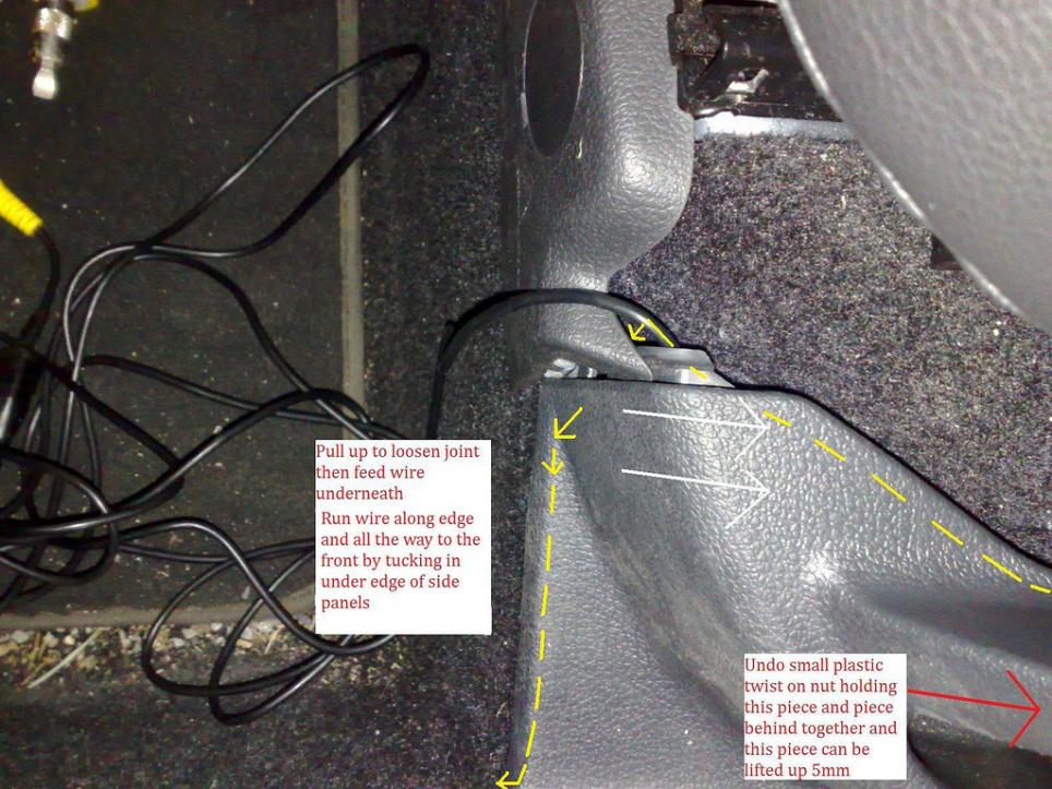

      final tidy up - no need to remove panels inside the car unless you are nuts or have OCD.

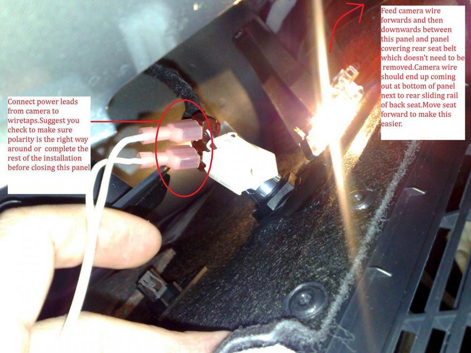

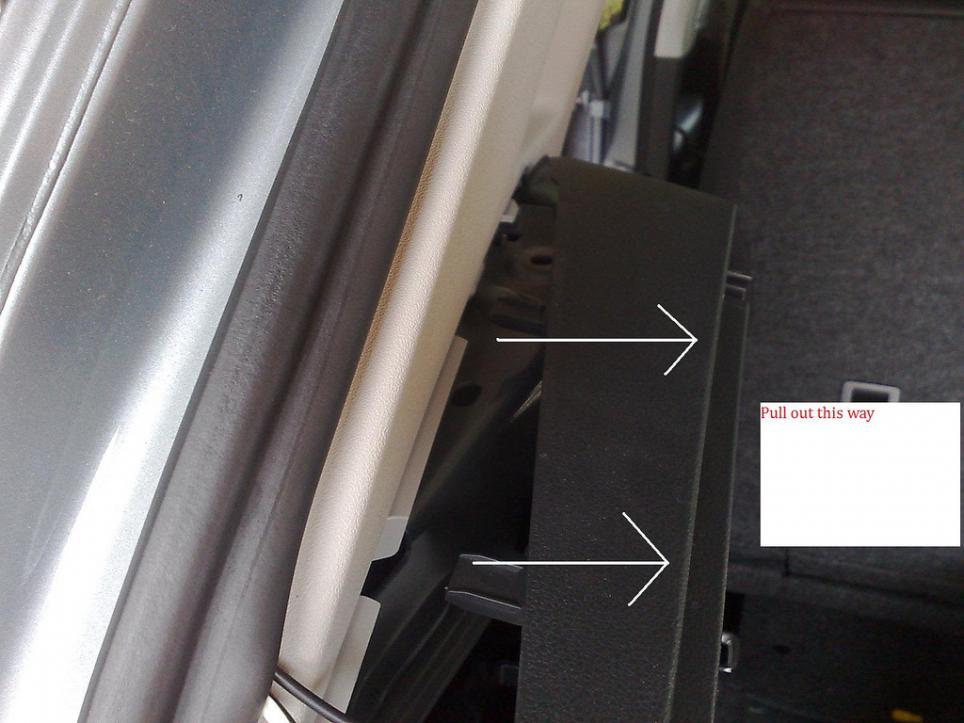

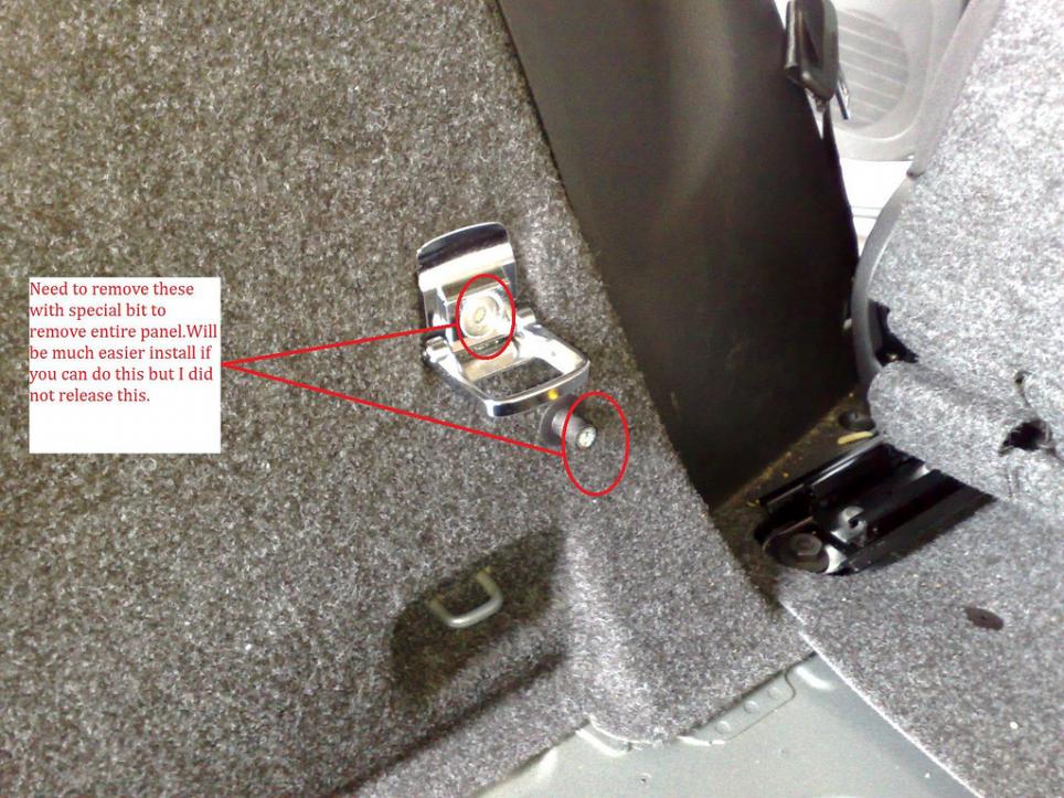

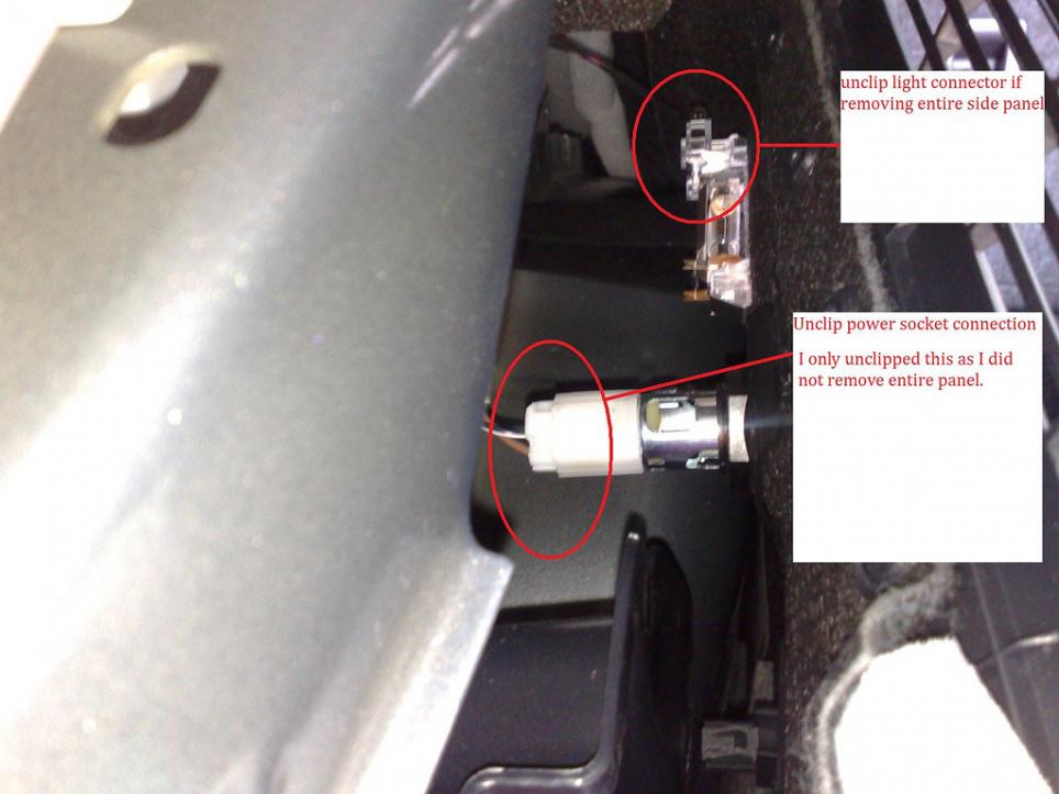

      Removal of rear left boot panel
      This step is optional , desirable but entails buying another tool
      Only clipped in so be gentle
      Looking inside/behind the panel

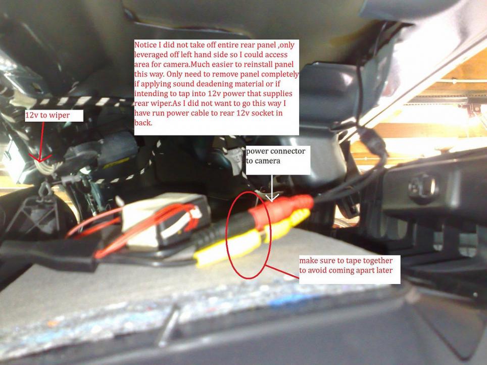

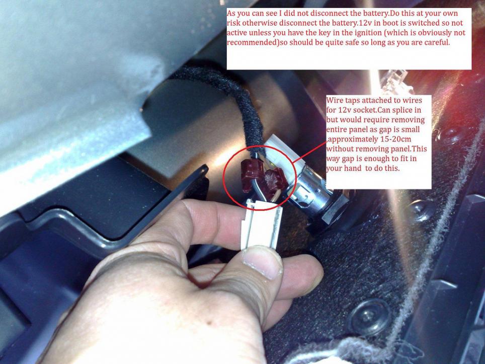

        Wiring up Power to Camera.
        Running video lead to head unit

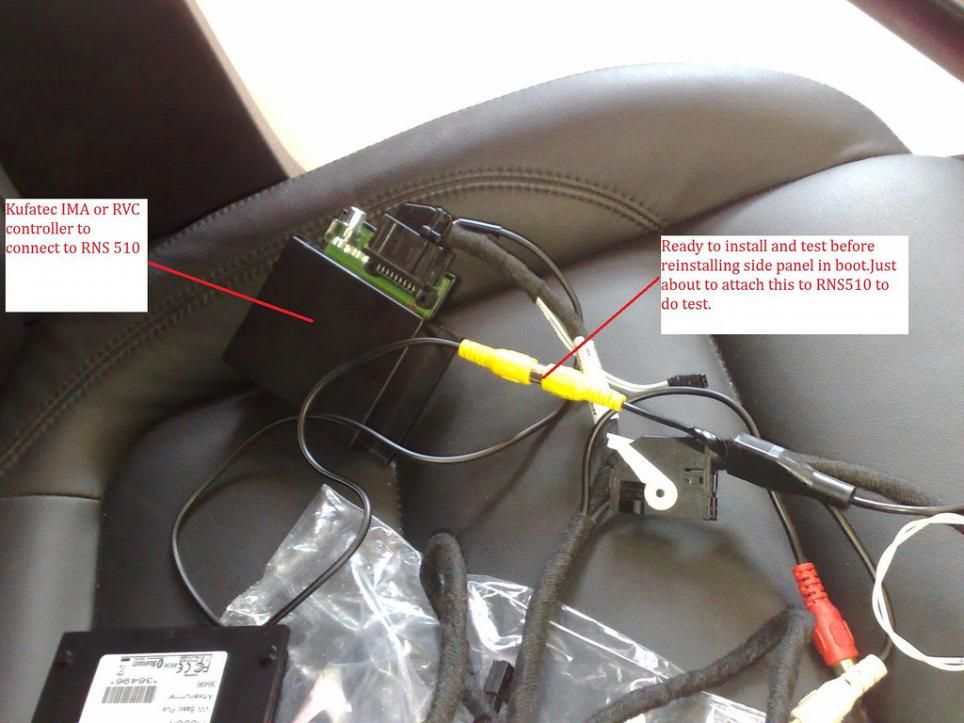

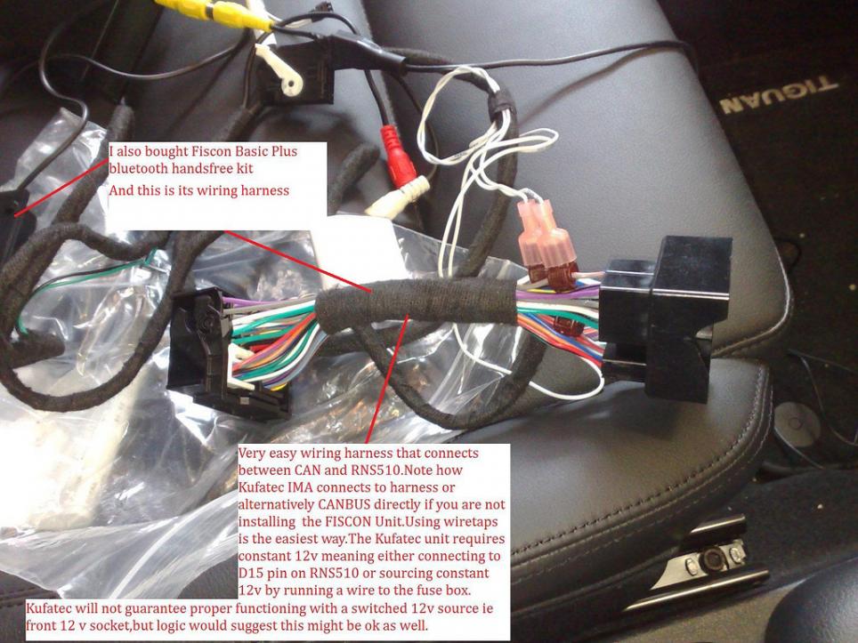

        The Kufatec IMA is required to gain video input in RNS510
        In this photo please note the wires connecting to the can bus.I have unwound them to make attaching them easier.It has taken me 9months to discover that this can cause inconsistency in how stable/reliable the RVC operates. The Can HIgh and the can LOW wires should be wound as closely together as possible to maintain signal integrity. You have been warned
          Reconnect all the wiring and enjoy .

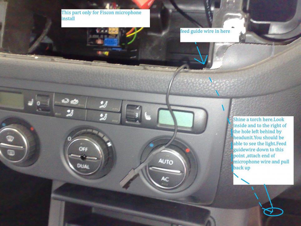

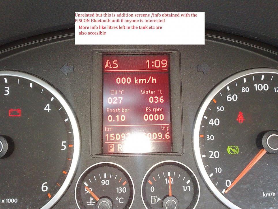

          This bit is for FISCON BLUETOOTH UNIT that I installed at the same time
          I hope everyone has found this helpful. Personally it has been a very enjoyable exercise.It has taken alot of time and research to complete this and is really there for those of us who like to tinker.For any new car buyers reading this,I think I am still undecided on wether I would still pay the additional A$3500 for the rns51- rvc optional package or follow the path that I have taken.Non tinkers pay the $3500. Tinkers save yourself over $1700

                BTW; I was unable to get my Boost Pressure to work on my Fiscon all the other extras work though...
                I used the Fiscon supplied microphone in the OEM position in the overhead console and it works brilliantly. No issues with voice clarity etc. Might be woth a try for you also.
                I will give it that complete OEM fit and feel.
                Not 100% keen on the placement of your mic though.
                But each to there own.
                Still, might be worth a try to move to the overhead console.

                      The fiscon kit should work as I have no issues and it will show the boost pressure.Only trick is there are seven data readings to show but only room for 4 in the DIS ,so using up arrow right hand buttons of MFSW will show you the battery voltage,boost pressure,boost bar and down arrow will display the litres left in the tank and estimated rpm in the bottom 2 position in the DIS.
                      I really really wanted to install into the OEM position and Fiscon have a guide for this and how to install the microphone correctly by removing the housing and fitting the microphone through a piece of high density foam/rubber which sits into the square recess behind the perforated section in the overhead console.
                      For other readers the Fiscon kit comes with 3 microphone bases,1 adhesive small flat base which I use,there is also a small clip on to mount to ??upper A pillar and a large clip on to mount to ??sun visor.
                      Having said that I am very happy with the sound quality from my position and I don't think it is noticable at all.
                      The bit that I didn't like was running the wire up the A pillar.As is stated in my guide it is important to replace all the attachemnt clips with new clips and especially the main anchor clip which is the uppermost most clip with special release mechanism. Maybe one day I will do this but at present I didn't want to stuff up the airbag operation.Obviously easy enough to do but I will wait until a guide for the tiguan is released....HINT,HINT.
