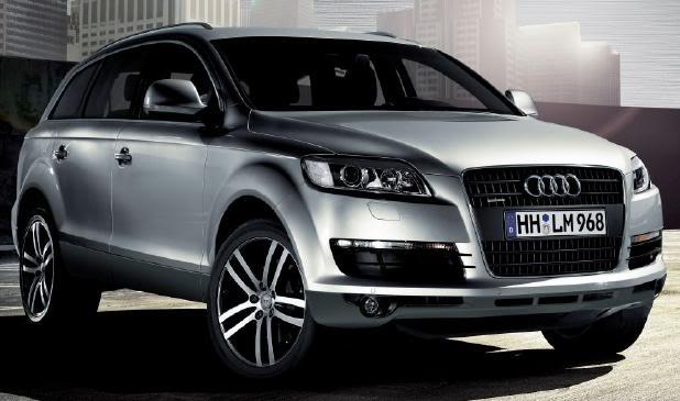

    Hi All,
    Just wondering if anyone has put 20 inch wheels on their Tiguan or if they fit.
    I am considering the Audi Q7 20 inch wheels, 9 inch wide with 275/45 tyres and VW centre caps.
    Apart from looking the goods, the 45 wall should still provide a decent ride quality, after all, these 20's are standard upgrade wheels for the Q7 (the entry level Q7 models have 18 inch wheels standard), albeit a bigger vehicle.
    I am looking at getting replicas which look very convincing. If the 20 inch wont fit, they are also available in 18 inch which are 8 inch wide and i imagine would have 255/55 tyres.
    I have seen the 45 wall and it actually looks ok, nothing like the stip of liquorice look thats for sure. Not too fussed about offset as i imagine i will get the chunky/wide stance/X5 look from the additional width of the wheel itself...could i be wrong here?

    You've gotta do some math behind your wheels. 275/45/20 is about a 30" diameter. Stock is 27". If that would even fit under the wheel wells, your speedo would be about 10% off.
    If you really wanted to do 20s, you would have to get tires with an aspect ratio of 35. 255/35/20 or 265/35/20 would work. Ride comfort would be seriously compromised. Go with 19s if you want to go big and really 255/40/19 is about as big of a tire as you should go. Make sure wheel offset is ET32-35 if you want chunky stance that is still correct. For 18s, 255/45/18 or 235/50/18 is the correct tire size.

      20"s have been done on the Tig not that big a deal, just gotta get the right offset and tyres. As a general rule of thumb stay at least 3% either side of your original tyre diameter.

            just another note. audi q7 wheels wont fit any way.
            they run larger 5x130 PCD fittings.
            i have a feeling this is because the toureg was designed in conjuction with the porsche cayenne ( which the audi q7 is somewhat a derivative of ).
            the tiguan has a 5x112 PCD similar to most audis vws and mercedes.

              If you realy want to run a Q7, Touareg or Porche Cayenne wheel you could get a FK Automotive 25mm bolt on spacer/PCD adapter with a 5 x 130 to 5 x 112 and brings the Q7 ET50 offset to the required 35.
              I am getting some 20"RS6 Replica wheels which I plan to run either 245/40/20 and 275/35/20 which give 27.7" rolling diameter for tad more sidewall as oposed to the required 27" which come on the 255/35/20 tyre, hopefuly the 0.7" or 17.78mm won't make much of a difference as far as steering clearance goes. Or if you want to be adventureous try squeezing in a set of BMW X5 spec 275/40/20 front and 315/35/20 tyres, might not fit but they sure would look the part.
