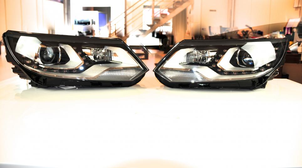

Hi what part of the install were you unsure of? I had my bi-xenon headlamps professionally retrofitted and also has the auto-levelling kit installed as well.
How much did it cost to have them installed and who by?
mostly the wiring. i manage to find some good info on the GTI fitting and coding VWVortex.com - Golf V GTI OEM Xenon Installation Completed. how close is it to the tiguans? do you need to change the wires on the central electric connectors?
I don't think the wires had to be changed but the main obvious parts of the install required Kufatec harness adaptors to convert the car halogen connectors to bi-xenon type then a new CCM as well because my version was not comparible.
Shouldn't that be 2012+ as these headlamps are from the facelifted Tiguan which was officialy launched last year. There are retrofit versions out there made by 3rd parties but these would not fit a 2011 model Tig.

hi guys, apologies for my late reply.
The lights are not super easy to fit but they are not too difficult.
We do have installers in most major Aussie cities. Ligghts are brand new Aussie spec.
The cost to fit is 400-800 depending on location in australia.
We have RNS 510 units, cameras and Bluetooths for the previous model 2008-2011

Check the ADRs - Xenons are not legal fitment unless they have washers and self levellers.

putting the headlights in are easy with the right harness. installing the AFS system is the hard part. if $400 is inclusive of the whole thing then its pretty cheap. nvm by the looks of it your not selling the AFS system with the leveling arms...
Was another thread about fitting these to something and to do it with the washers and levellers was well into 4 figures and a lot of time
