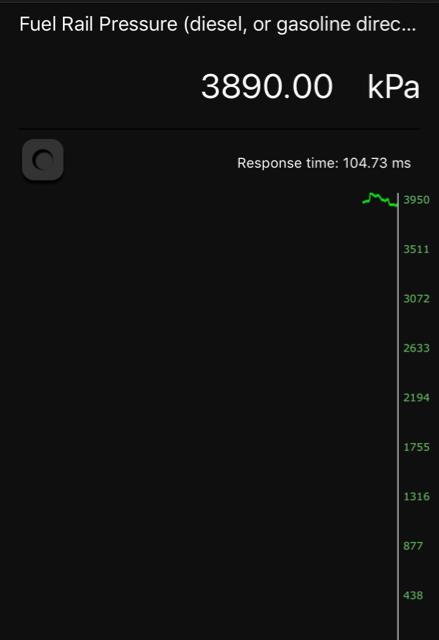

          My fuel rail pressure reading is as below. Does that seem high?

              Dont look at single blocks, there's requested and actual pressures and usually one that calculates the deviation between them.

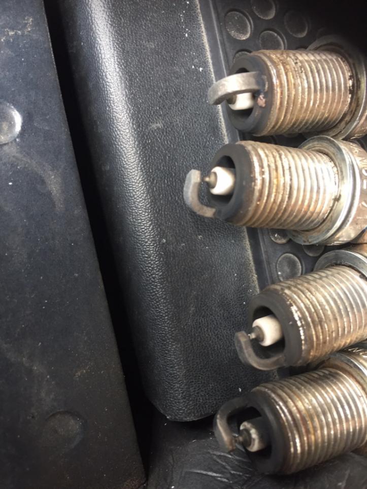

                  If all four plugs are black, I'd be thinking about the HPFP. Although this is just my theory, I havent looked to see if seals have failed on this style pump.
                    These are my plugs after 700kms.
                    I did also see that one of my coil packs (4th one) were discoloured/ bronze in colour in comparison to the original silver they come in.
