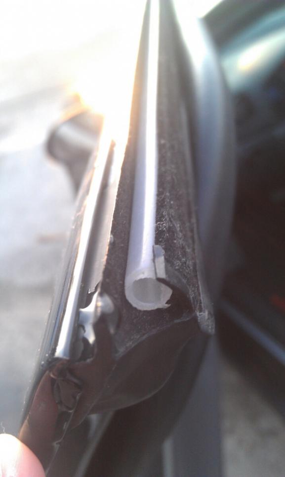

    There was a similar issue with Mk6 Golfs. Fix was fitting a piece of tubing under the door seal. But yes very annoying.
    Tigger, are you able to elaborate on this a little further?
    I have this problem too and am super keen to fix.
    • #17
      Just do a google search for Mk6 Golf wind noise fix. Plenty of info out there.
      Get some 1/4" tubing and place it behind the seal:
      - Tigger73's 125TSI Build
      • #18
        Brilliant, thanks!!
