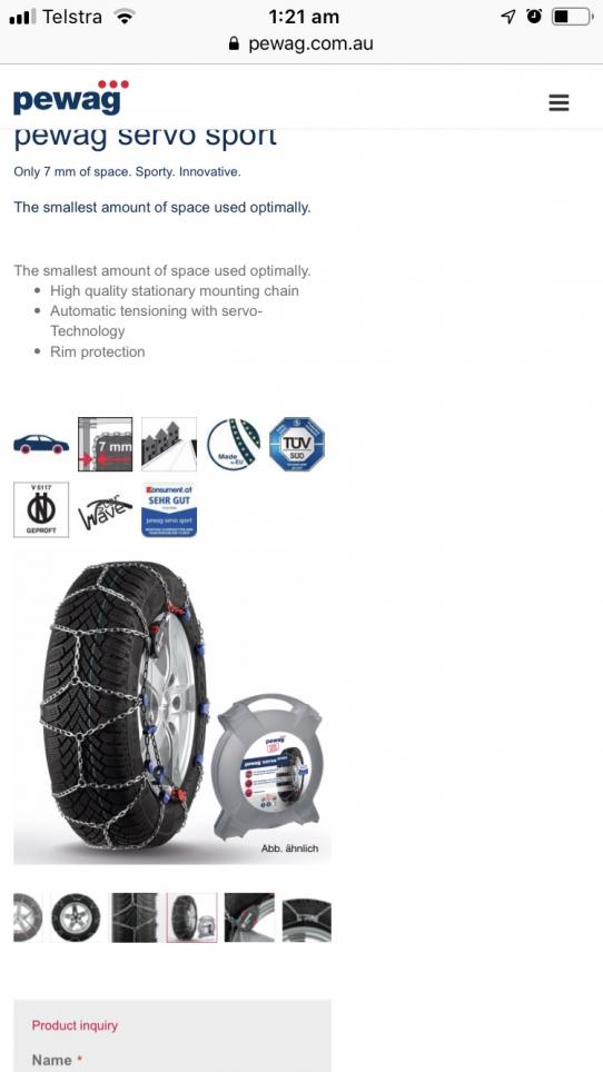

                          Did anyway try these or heard of them, 7mm so they should fit?? Apparently these go for under $300 a set
                          Sent from my iPhone using Tapatalk Pro

                              Again, if someone says these will do the job on an R Line, I’m in! Please keep us posted anyone who tries them?

                                Just saw it looks like they definitely have a set that fits the 255/40/20 tyres. Have sent and enquiry and will update..
