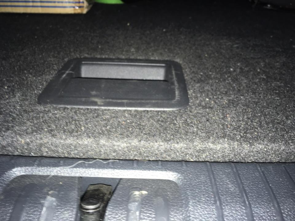

                  Ok took some shots of the tyre well with full size 17” Tulsa wheel installed.
                  One of the limiting factors of fitting the floor with full-size wheel is the handle on the floor which protrudes into the subfloor area:
                  So I decided to try removing the back off the handle to get a little more clearance:
                  Only busted one clip [emoji21]
                  In case anyone is trying this here’s what the clips look like:
                  Boot floor sits marginally lower now:
                  - Tigger73's 125TSI Build

                      The tyre on the 17x7 Tulsa is a 215/65R17 so is already pretty narrow. This is the reason I didn't go with a "matching" 20" Kapstadt or even a stock 18' rim as they both run a 235 width tyre and would push the boot floor higher. With the modified handle it almost sits flush on top of the spare wheel.
                      I think if you pulled the handle completely off you'd get the boot floor sitting on the spare wheel and not have a "high spot" at all. Though now with the back of the handle off it's barely noticeable.

                          Yeah I'm happy with how the boot floor sits - it's on the high setting and only just sits a fraction higher at the boot lip than it "should" on the higher setting. You can still use the space underneath you just have to raise the floor to get to it.
