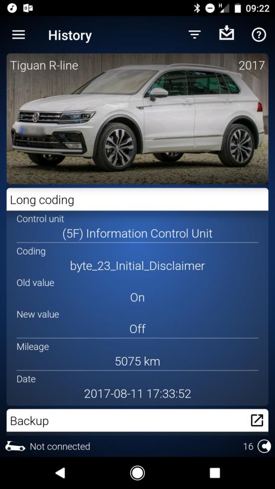

        5F...?
        Can you please list OBDeleven steps for Tiguan to disable that message ?
        Sent from my HTC One M9 using Tapatalk
        • Originally posted by Aus_fas View Post
          5F...?
          5F is the module number which in OBDeleven is listed in the circle on the right had side on the list of modules. From memory I think module 5F will be the Infotainment Control Unit.

              This might help.
              2017 Tiguan 162TSI Highline/R-Line
              2017 Audi S3
              • Originally posted by Gladbach View Post
                This might help.
                Excellent, thanks

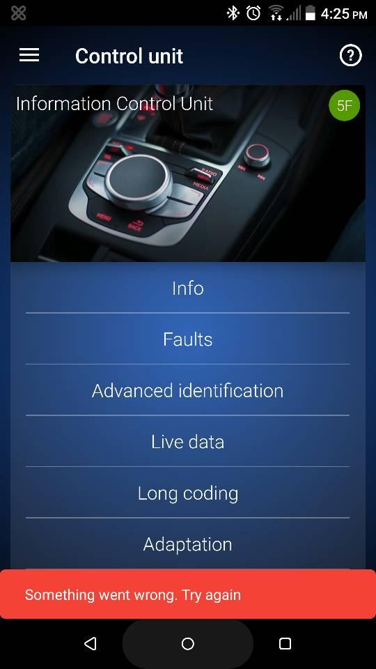

                  Getting an error on long coding as soon as I select this
                  • Cleared app data... fixed it.

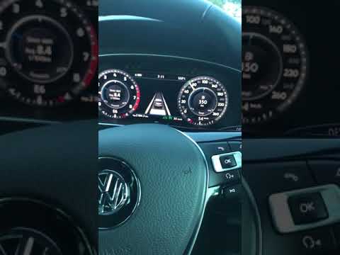

                    • Did a quick vid this morning of lane guidance working below 60km/h:
                      • Nice, Hugo, when do you think you will get your OBDeleven?
                        • Originally posted by Hugo_nz View Post
                          But you had it already activated on buying the car? Or did you activate it in a later stage through VCDS? Or did you only activated ALG and then TJA was also working?

                            I think Hugo couldn't get OBD eleven on-time before the software update by dealer. Once Hugo provides the scan peanut or Golf_nz might be able to find out the bits that are different to help all of us [emoji10]
