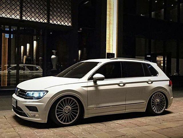

    It should look something like this...

      @AEROBERGERKLOPS: yep something like that without the lowered body . Nice car by the way, yours?
            No, not mine. I've got the R-line kit on mine
            But it definitely looks better colour coded than not, if ur not looking at getting the R-Line pack. It would also help if u knew people in the business that could give you a quote on how much it would take to do so you could weigh up ur options. Good luck!
