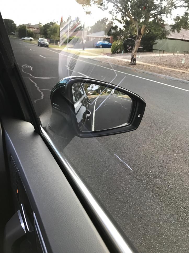

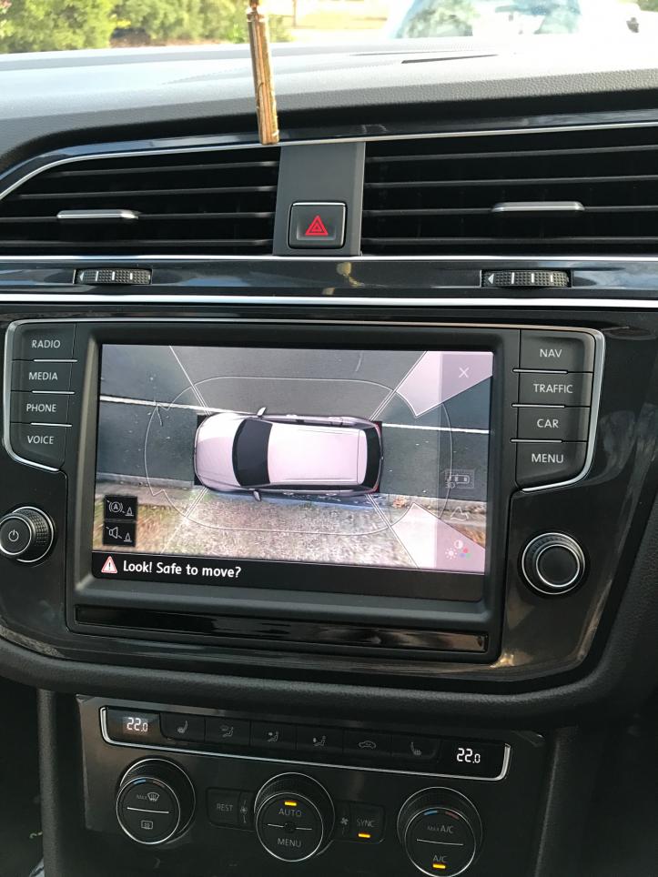

    • Seriously wtf..... [emoji23][emoji23][emoji23] I gotta take it back so they can readjust the cameras.
            There is a calibration of the camera that can be done by the dealer. It involves a wheel alignment of all four wheels and then a pattern is laid down around the vehicle for it to calibrate to.
            It's time consuming so the dealer won't want to do it.
            For anyone that has this type of 360 camera, if you disconnect one of the cameras for any reason (replacing a side mirror, front bumper or boot) you will have to have the camera recalibrated. Don't know what VW dealers charge for it, but Audi dealers charge roughly $1500. Make sure you factor this in if you're involved in an accident and you may have to recalibrate the camera, make sure its included in the panel beaters quote.
            From the photos it looks like yours was never calibrated correctly from the factory, or was done in a rush to fill demand for these vehicles. Push the safety line. It's an aid to parking which is giving you incorrect guidance. I'd also be concerned that the park assist may also be out of calibration.
              For anyone that has this type of 360 camera, if you disconnect one of the cameras for any reason (replacing a side mirror, front bumper or boot) you will have to have the camera recalibrated. Don't know what VW dealers charge for it, but Audi dealers charge roughly $1500. Make sure you factor this in if you're involved in an accident and you may have to recalibrate the camera, make sure I ts included in the panel beaters quote.
              True, thanks for your info filled response [emoji1360] I will ask next time I go in. If they ask me $1500 for it even though it's their fault I'll just decline and take it on the chin. It's annoying but I can live with it.

                No brainer this will be covered by warranty. It's out of calibration from the factory. Don't even entertain paying a cent for it.
                Don't just live with it. It will annoy you every time you use it, and you may scrape a rim one day using its incorrect information. Get it fixed.
                  Even the automatic parking is inconvenienced by the bad calibration. Luckily when I used this once for parallel parking, only my tyre touched the curb thank God!!!! Those R-Line Rims could've been destroyed! [emoji33]
                  But thanks, I will argue that it should be covered by warranty.
