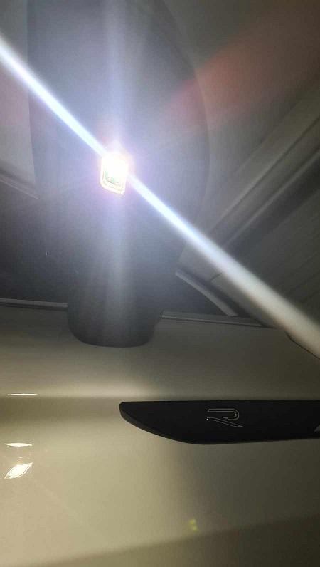

    1. Added puddle lights into the side mirrors? (Not replaced the red inside door reflectors).

    Rline Allspace has puddle lights on the mirrors though. No Tiguan had the exterior handles with led (if you mean like those on a mk8 Golf), only in the interior

        Thats odd, mines a 2023 build. Maybe dealer is confused with the door warning lights? Only thing we didnt get on our car as ordered was the blind-spot monitoring cause of the chip shortage but I had new oem ones installed that I bought from Kufatec. Our Tig is without a sunroof (learnt my lesson having one in the R36) but all the options were ticked. Regarding the led handles, maybe on the chinese model? I know they other got options such as interior LED strip above the glovebox. Shame its LHD though.

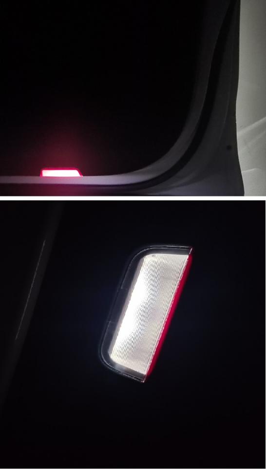

        All ive bought from China were the rear footwell lights & added foot vent covers. Everything else I added like the larger R paddle shifters, black fake exhaust replacements, Side Assist kit, inlet manifold cover and door warning lights were from Kufatec/Germany

          I think you are right. The salesperson thinks the puddle lights are the red reflectors on the door. 1 issue ressolved.

          One question, which door warning lights did you add to the car?
          Thanks again for your info and sharing images.
            Nice! ready for the new year then. The lights I added replaced the reflectors on the bottom of the door
